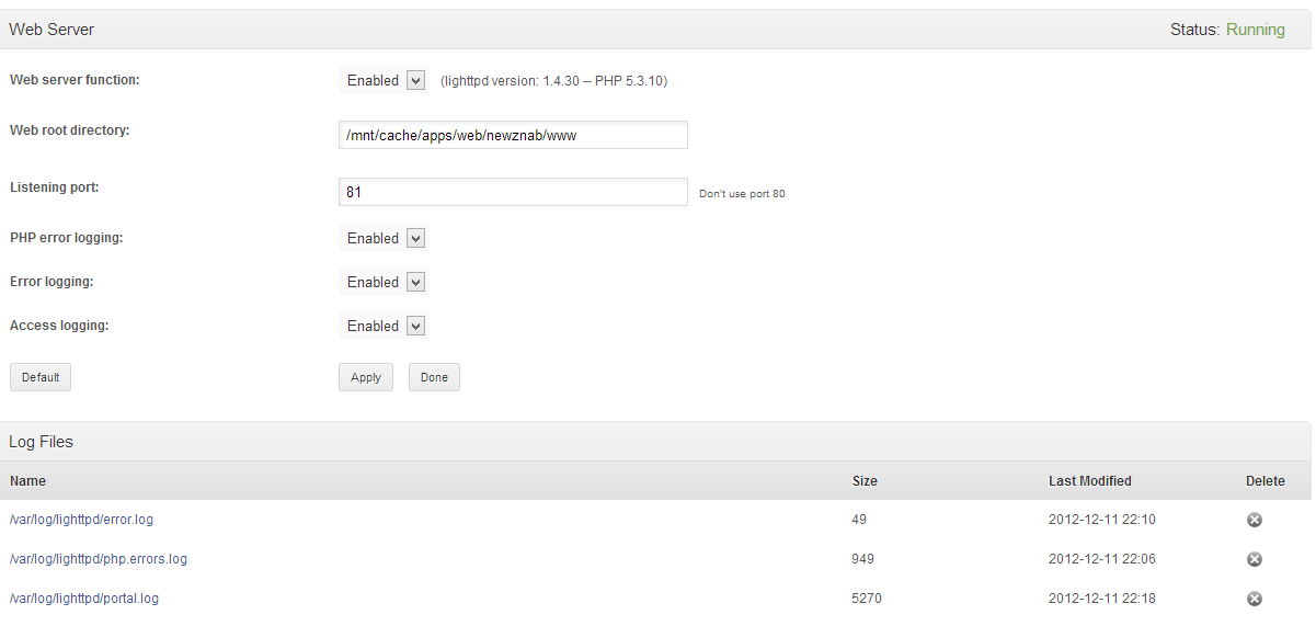

Hmmm....thats odd.  Once you have created the default directory on your box and then updated the web root directory to match everything should be good to go.  All you have to do then is create any old index.html in that directory and you should be able to pull it up.  I attached what my screen looks like with my current setup.
