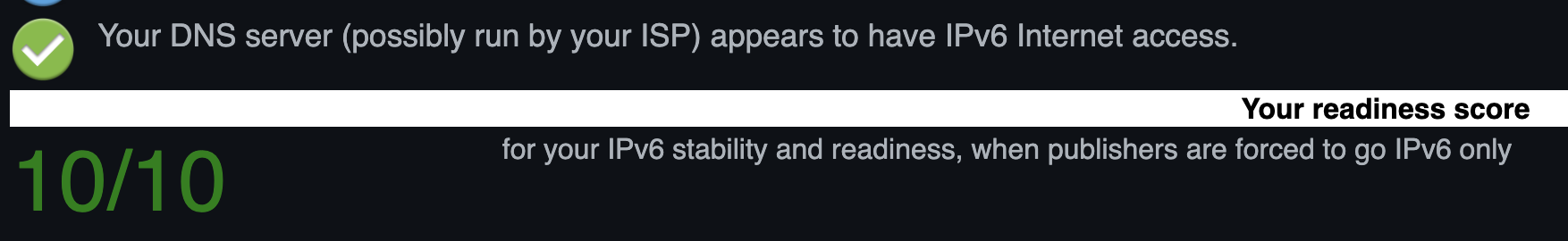

P.S. I did notice that my ipv6 was borked (test would show timeout on getting ipv6 connections), dunno for how long and I honestly don't have much idea how I fixed it. I am running my router in bridge mode with my asus router configured to use Adguard Home container DNS settings for both ipv4 and ipv6 but the latter is not locked into specific address unlike ipv4 which I have a rule to assign same ip address each time. After reading more about ipv6 I think I may have misunderstood how the whole ordeal worked and now I am passing ipv6 tests in https://test-ipv6.com/
