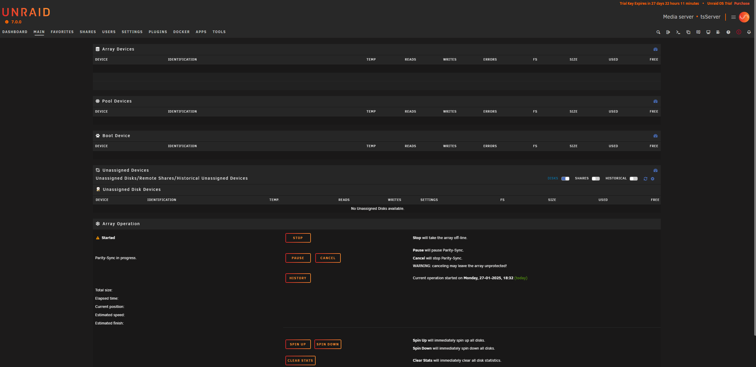

After running for some time, all my disks suddenly become invisible, and I’m no longer able to use Unraid properly.
Even the “Fix Common Problems” plugin can’t scan anymore. However, I’m still able to stop and start the array, but it doesn’t solve the issue.
The only way to get things working again is to restart Unraid. But after restarting, the system only works for 1–2 hours before the problem happens again.

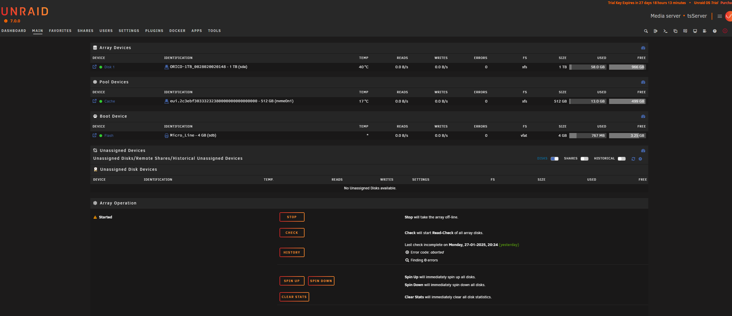

here normal:
here with bug:

He meant the USB array disk, but try using a different browser, if it still happens, logout from the GUI, wait at least 30 seconds, then log back in.
Yes, that could actually be the case now that I think about it. I use Brave and have often had issues or display errors.
I will try, thanks!
