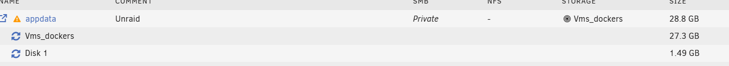

Your appdata share has files on the array

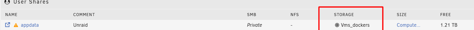

Click Compute... for the share.
Also
Jan 31 02:44:57 BdrTec root: Fix Common Problems: Warning: Share appdata set to cache-only, but files / folders exist on the array

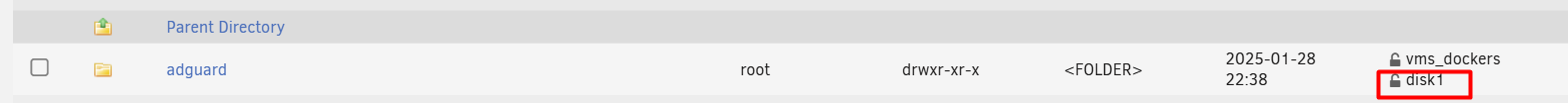

How can I solve this?
How do I know which files to move?

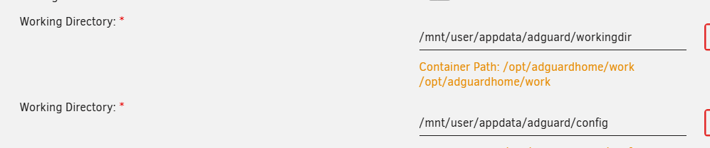

One question: when I put a file in /mnt/user/appdata it automatically maps to /mnt/Vms_dockers ?

Set appdata to Primary:vms_dockers; Secondary:array; Mover action:array->vms_dockers.
Nothing can move open files, so Disable Docker in Settings.
Run Mover in Main - Array Operations. Wait for it to finish.
Then post new diagnostics.
It goes to Primary storage for the share, or it overflows to Secondary if Primary has less than Minimum Free.
You currently have no Minimum for vms_dockers, so no overflow. You should set this to larger than the largest file you expect to write to that pool.
Probably the appdata files that are on the array were put there when you didn't have vms_dockers, and since you had no Mover action set for the share, that is where they stayed.

If you want the "standard" mover to skip some shares while you use it to move appdata from disk1, you can just set those other shares to Secondary:none.
Or you can move appdata from disk1 to vms_dockers yourself using Dynamix File Manager. Might even better to try that since mover won't overwrite files. That way you can clean up any duplicates there might be between appdata folders on disk1 and vms_dockers.
