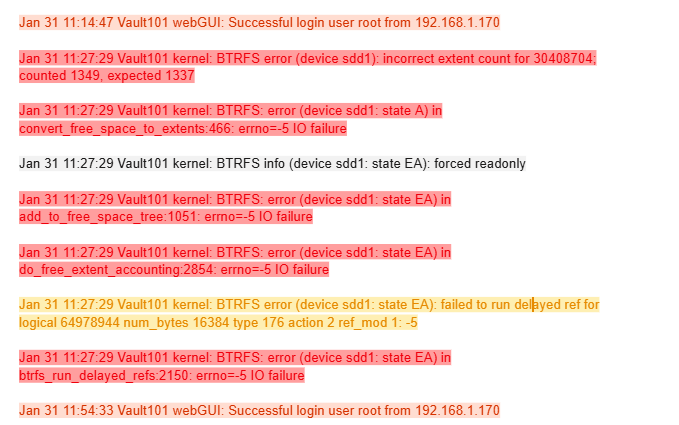

noticed the following in logs could this be related ?
vault101-diagnostics-20250131-1201.zip
Edited by LoyalScotsman
Jan 31 11:27:29 Vault101 kernel: BTRFS error (device sdd1): incorrect extent count for 30408704; counted 1349, expected 1337
Jan 31 11:27:29 Vault101 kernel: BTRFS: error (device sdd1: state A) in convert_free_space_to_extents:466: errno=-5 IO failure
Jan 31 11:27:29 Vault101 kernel: BTRFS info (device sdd1: state EA): forced readonly
The pool has filesystem issues, with btrfs I recommend backing up and reformatting.
