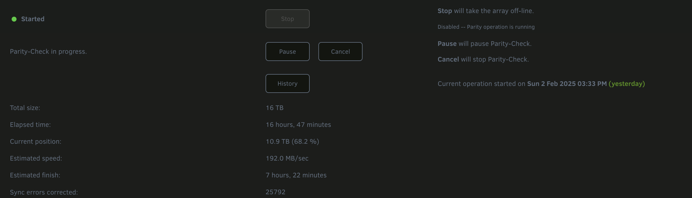

I'm not fully declaring victory yet - but a new PSU seems to have either fixed things or at the very least made things much better. I'm nearly 17 hours (68%) into a parity check and a few things of note:
1.) There have been no COMRESET errors (or any logged errors actually) for any of the drives
2.) The parity check is identifying and correcting quite a few sync errors (presumably those created from the disk / comm issues experienced on the parity rebuild that was occuring when I was seeing a high number of COMRESET errors)
I'll report back when the parity check is complete and after I've had time to add one of the other drives I gave up on due to this issue in the past. At that point I'm hopeful I'll be able to mark the new PSU as the solution this this issue thread.

Ok, reporting back - I can definitively confirm this was the solution.
I have confirmed in two ways:
1.) The drive throwing me errors that led to me initiating this post - I have completed a full parity rebuilt (it was the parity disk in the array) and the rebuild completed - corrected ~25k parity errors and the disk threw no errors during the whole rebuild (and hasn't throw any errors since)
2.) I put another white label drive that had persistently thrown COMRESET error the last time it was in service ( and I had given up) back in the server and successfully complete a full pre-clear cycle (pre-read, zeroing, and post-read) with out  throwing any error.
Thank you for the suggestion - looks like I fell victim to a cheap PSU purchase.
