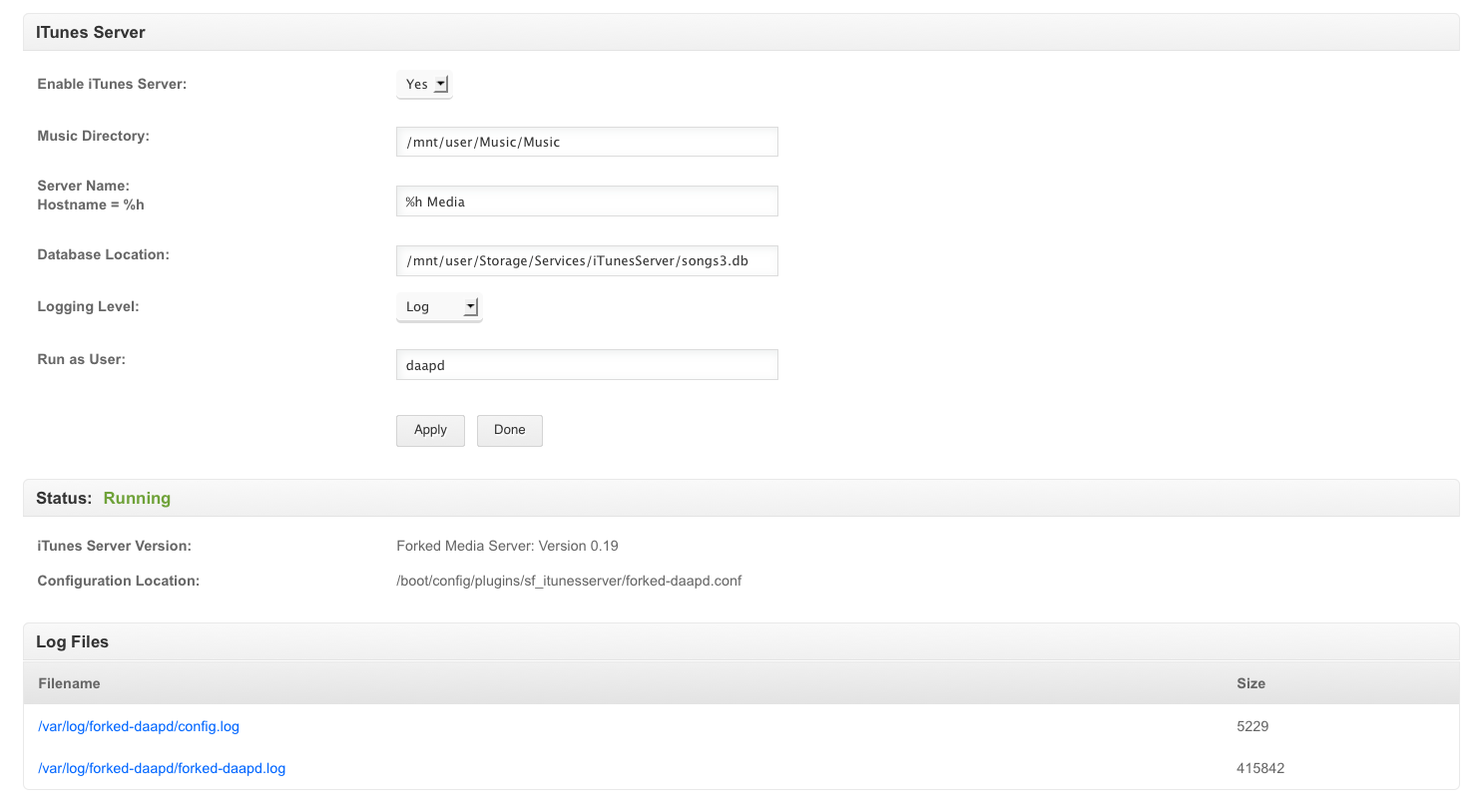

I've created an iTunes Server plugin! Been wanting something like this for ages, but the old packages didn't have support for the latest iTunes. This package uses the very latest builds of forked-daapd, with no disconnection/timeout issues (hopefully!).
It can take a while to scan and load your music library into its database. For my library it took 3-4 hours to load all the metadata into a 45Mb database. Be patient if you have lots of music! The server is useable even if it hasn't scanned everything. If you want to re-scan your library you'll need to stop & start the server.
Download from Google Code: simplefeatures_itunesserver.plg
Requires unRAID Version 5 Beta 12 and above.
Features:
Forked Daapd Server: Fast & Light iTunes Server
WebGui Control: Stop/Start your iTunes server, control location of music database & server name. Check logs & version numbers.

I have set up a simple test server (my main rig is still on 4.7 and i did not want to mess with my backup server which is on 5.0b14).  So, I have put together an i3-2125 CPU, 4G Ram, Asrock H67M-ITX motherboard and a 500GB hard drive (recycling my Hackintosh until I want to play with it again).  Basic unRAID 5.0b14 works on this hardware.  I have the base level Simplefeatures installed, and then I added the iTunes plugin.  I have some music loaded into a share, and I have set up paths to the music folder and to a folder for the database creation.  When I start the iTunes server, it opens a database file, opens the log files and then stops.
This is what's in the config.log...
Start: April 15, 2012 01:20:09 PM
SERVICE: enable
MUSICDIR: /mnt/user/TESTMUSIC
DATADIR: /mnt/user/DB/songs3.db
LOGLEVEL: log
RUNAS: daapd
CMD: sed -i -e '/^loglevel/cloglevel = "log"' /boot/config/plugins/sf_itunesserver/forked-daapd.conf
Results:
CMD: sed -i -e '/^directories/cdirectories = { "/mnt/user/TESTMUSIC" }' /boot/config/plugins/sf_itunesserver/forked-daapd.conf
Results:
CMD: sed -i -e '/^name/c ame = "%h Media"' /boot/config/plugins/sf_itunesserver/forked-daapd.conf
Results:
CMD: sed -i -e '/^db_path/cdb_path = "/mnt/user/DB/songs3.db"' /boot/config/plugins/sf_itunesserver/forked-daapd.conf
Results:
Results:
CMD: chmod -R 0777 "/mnt/user/DB"
Results:
Results:
Results:
Results:
Results:
Results:
Results:
CMD: /etc/rc.d/rc.forked-daapd stop
Results: Stopping RSP and DAAP media server: Not running!
CMD: /etc/rc.d/rc.forked-daapd start
Results: forked-daapd.
End: April 15, 2012 01:20:10 PM
And here's the forked-daapd.log...
[2012-04-15 13:20:10] main: Forked Media Server Version 0.19 taking off
[2012-04-15 13:20:10] main: mDNS init
[2012-04-15 13:20:10] mdns: Avahi state change: Client connecting
[2012-04-15 13:20:11] mdns: Failed to create service browser: Bad state
[2012-04-15 13:20:11] player: Could not add mDNS browser for AirTunes devices
[2012-04-15 13:20:11] main: Player thread failed to start
[2012-04-15 13:20:11] main: File scanner deinit
[2012-04-15 13:20:11] main: Database deinit
[2012-04-15 13:20:11] main: mDNS deinit
[2012-04-15 13:20:11] main: Exiting.
I am at a loss as to know what to look for.  I am a long time user of Firefly (mt-daapd before the code was forked) and I am used to some of its many quirks, but this is a new one.
Any ideas welcome.  Thanks.
What does it bring up if you enable debug logging?
Thanks for responding.  I get this in the forked-daapd.log
[2012-04-15 23:29:58] main: Forked Media Server Version 0.19 taking off
[2012-04-15 23:29:58] main: Initialized with gcrypt 1.5.0
[2012-04-15 23:29:58] main: PID: 2898
[2012-04-15 23:29:58] main: mDNS init
[2012-04-15 23:29:58] mdns: Initializing Avahi mDNS
[2012-04-15 23:29:58] mdns: Avahi state change: Client connecting
[2012-04-15 23:29:58] main: Initializing database
[2012-04-15 23:29:58] db: Running query 'SELECT value FROM admin WHERE key = 'schema_version';'
[2012-04-15 23:29:58] db: Running query 'ANALYZE;'
[2012-04-15 23:29:58] db: Running query 'SELECT COUNT(*) FROM files f WHERE f.disabled = 0;'
[2012-04-15 23:29:58] db: Running query 'SELECT COUNT(*) FROM playlists p WHERE p.disabled = 0;'
[2012-04-15 23:29:58] db: Database OK with 0 active files and 4 active playlists
[2012-04-15 23:29:58] db: Running query 'DELETE FROM inotify;'
[2012-04-15 23:29:58] db: Running query 'SELECT s.selected, s.volume FROM speakers s WHERE s.id = 0;'
[2012-04-15 23:29:58] db: Running query 'DELETE FROM groups;'
[2012-04-15 23:29:58] raop: Timing IPv4 port: 39458
[2012-04-15 23:29:58] raop: Control IPv4 port: 52358
[2012-04-15 23:29:58] mdns: Adding service browser for type _raop._tcp
[2012-04-15 23:29:58] mdns: Failed to create service browser: Bad state
[2012-04-15 23:29:58] player: Could not add mDNS browser for AirTunes devices
[2012-04-15 23:29:58] main: Player thread failed to start
[2012-04-15 23:29:58] main: File scanner deinit
[2012-04-15 23:29:58] db: Running query 'UPDATE files SET songalbumid = daap_songalbumid(album_artist, album);'
[2012-04-15 23:29:58] db: Running post-scan DB maintenance tasks...
[2012-04-15 23:29:58] db: Done with post-scan DB maintenance
[2012-04-15 23:29:58] main: Database deinit
[2012-04-15 23:29:58] main: mDNS deinit
[2012-04-15 23:29:58] main: Exiting.
The config.log is very similar to previously...
Start: April 15, 2012 11:29:57 PM
SERVICE: enable
LOGLEVEL: debug
RUNAS: daapd
CMD: sed -i -e '/^loglevel/cloglevel = "debug"' /boot/config/plugins/sf_itunesserver/forked-daapd.conf
Results:
Results:
Results:
Results:
Results:
Results:
Results:
Results:
Results:
Results:
Results:
Results:
End: April 15, 2012 11:29:58 PM
Any thoughts?
Make sure all of your network settings are solid. Also see if enabling AFP makes a difference. It's failing on the mDNS service creation, not too sure why that would be.
Wow!  Genius!
It seems to need AFP enabled for some reason.  Am now about to set up with my full library.  Will report back
Thanks again!
Hmmm,  I'll need to look into that. It seems Avahi isn't enabled until AFP is enabled. I'll need to turn on Avahi beforehand, hopefully that won't interfere with AFP/SMB service discovery.

Uploaded new version of the PLG installer. Fixed so Avahi is started before iTunes Server. No need for AFP to be enabled now.
Please re-download and install!

That works!
I did a quick check - set AFP to No, restarted server to check problem was still visible.  It was.  Then I deleted the previous .tgz, copied over the new .plg, left the previous sf settings folder in place, rebooted the server.  iTunes server is now up and running again without having to have AFP enabled.  Perfect.
Thanks again for this (and for SimpleFeatures).  :)
