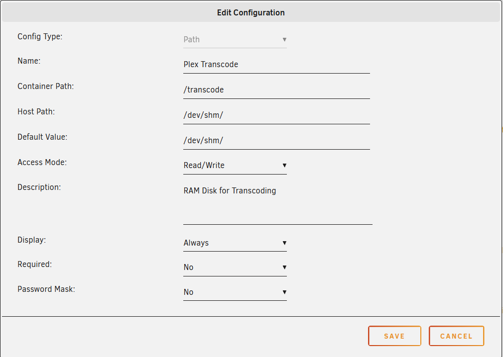

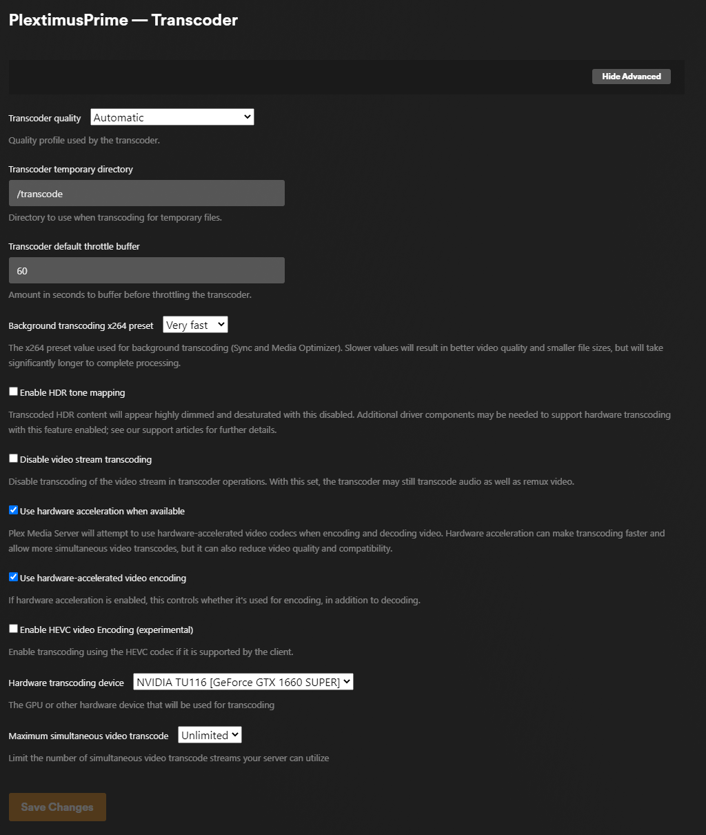

Hi I am running into an error with Transcoding on my Plex. I recently replaced my cache ssd (it was starting to fail) and also replaced my RAM (as it failed Memtest, new RAM ran for 2 days+ and passed with no errors). I decided to switch to RAM transcoding to save my SSD from all the reads/writes but now I am running into an (An unknown error occurred (4294967283)) when I try to transcode and if I click retry it will sometimes play but I will get this error about 60 seconds in and it will force close the session (Conversion failed. A required codec could not be found or failed to install.) Checking the Plex Logs I see this error:

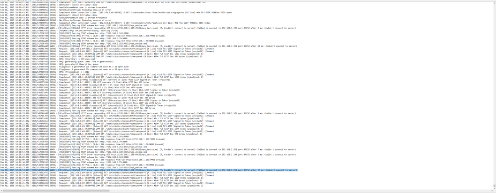

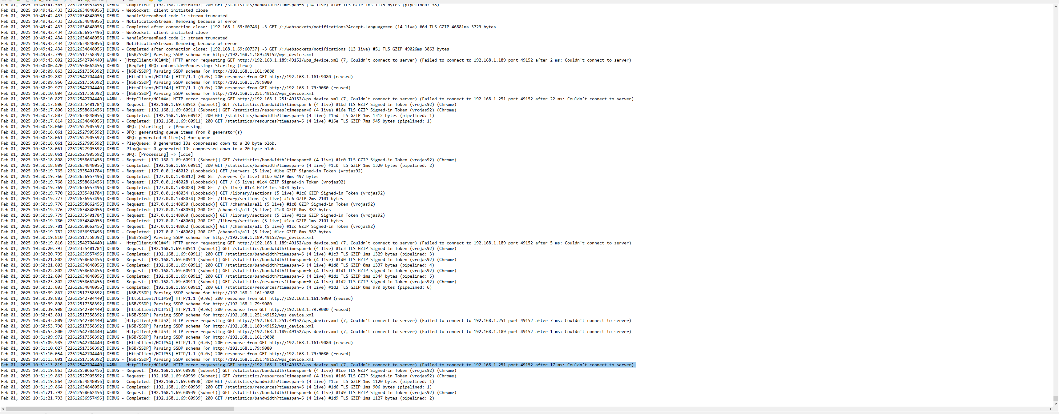

Feb 01, 2025 11:40:19.529 [23102739303224] WARN - [HttpClient/HCl#cc] HTTP error requesting GET http://192.168.1.189:49152/wps_device.xml (7, Couldn't connect to server) (Failed to connect to 192.168.1.189 port 49152 after 2 ms: Couldn't connect to server).

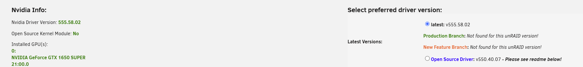

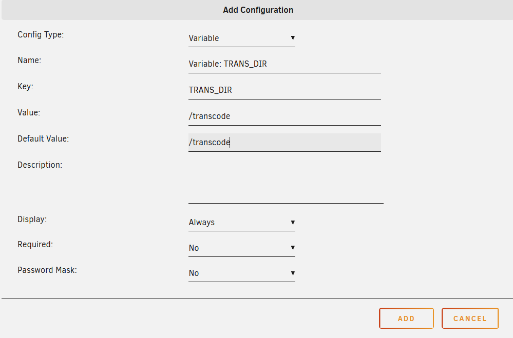

I am also noticing that the NVIDIA Driver plugin correctly shows my 1650 Super but in plex it is picking it up as a 1660 Super. I've attached pictures of how I have configured RAM Transcoding. (Variable: TRANS_DIR was already in the template for Binhex-Plex so I'm not sure if it is needed or not.)
These are my extra parameters in plex:
--runtime=nvidia --mount type=tmpfs,destination=/dev/shm/,tmpfs-size=20000000000 --no-healthcheck

Attached are my syslogs as well as my Plex Media Server Logs. If you need anything else please let me know.
