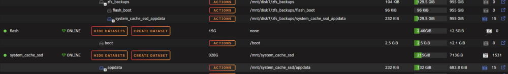

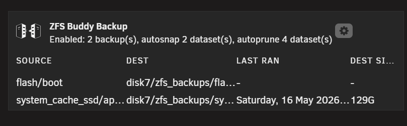

Hello "Pirat",
For my very first post on the forum, I wanted to thank you for this one.
I've just installed it to make it easier for me to create snapshots with Sanoid (it's installed but I'm stressed about using the command line).
Your interface is just perfect for me!
I can see that I do have snapshots appearing in the “ZFS Master” plugin.
As I write these lines, I haven't yet tried to restore a snapshot. I'll have to get on with it.
See you soon :D

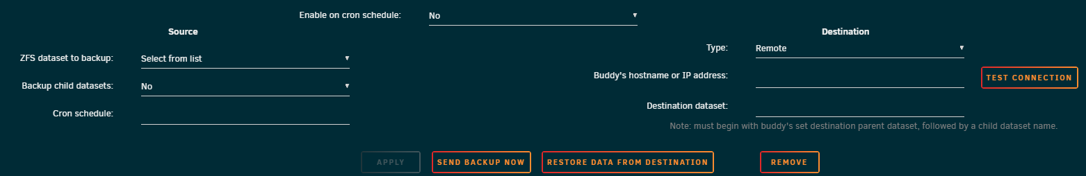

I'm not even able to select a disk with ZFS buddy, the drive is set as ZFS encrypted in the screenshot below:
However, when making a schedule, I'm not able to select the disk from the dropdownlist. It's grayed out for selection.
Are there maybe any particular steps I might have forgotten?
Thanks!

What you are showing in the first screenshot is that you have full disk encryption set in Unraid (luks). This is different than zfs dataset encryption. In order to send raw encrypted zfs datasets, they have to be encrypted by zfs. You can still have luks as well but it might be unessesary depending on your needs.
The easiest way to create an encrypted zfs dataset in unraid is to use the ZFS master plugin.
