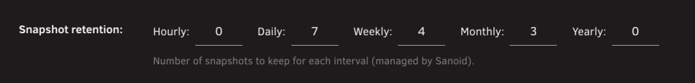

The plugin automatically runs Sanoid every 15 minutes, and when it runs, Sanoid checks whether any new snapshots should be created or pruned according to the config. Sub-hourly snapshots are not exposed in the GUI (I should perhaps add that),
In my main sever I have already snapshots + Backups from script (system_ssd/appdata) made yesterday at 20:00 and I don't see that plugin made any snapshot or backup Hovewer in dashboard it wrote that made somethink..
Also added snapshot for flash/boot and also can't see any snapshots.
I can see in log only that synchronise ok
Also seems we need to add retensions for local backups in snapshots menu, do you think will be useful to add strict mode option maybe to syncoid?
If it not over complicate the plugin?
23 minutes ago, Pirat said:
The "Snapshot creation and pruning" is pretty much just a GUI for the Sanoid config file. The plugin automatically runs Sanoid every 15 minutes, and when it runs, Sanoid checks whether any new snapshots should be created or pruned according to the config. Sub-hourly snapshots are not exposed in the GUI (I should perhaps add that), so the most frequent backup you can set is hourly by setting snapshot retention hourly > 0. Sanoid will then automatically create snapshots every hour.
    system_cache_ssd/appdata@autosnap_2026-05-13_20:00:03_daily	56 KiB	232 KiB	56 KiB	off	0	2026-05-13 20:00:03
	system_cache_ssd/appdata@autosnap_2026-05-14_20:00:03_daily	56 KiB	232 KiB	56 KiB	off	0	2026-05-14 20:00:03
	system_cache_ssd/appdata@autosnap_2026-05-15_20:00:04_daily	0 B	232 KiB	56 KiB	off	0   	2026-05-15 20:00:04
	system_cache_ssd/appdata@syncoid_MyTower_2026-05-15:20:00:17-GMT03:00	0 B	232 KiB	0 B	off	0	2026-05-15 20:00:17
sanoid.conf

Finally the first snapshot for /flash/boot was made in 14:15, interesting how sanoid choose when to make snapshot with (0 7 4 3 0)...
@Masterwishx
Strict mode, as in the snapshots in the destination are always kept mirrored from the source (--delete-target-snapshots), comes with some risks that make me prefer having pruning for local backups be a separate step. For example, if you mistakenly delete one or multiple snapshots on the source, then they will also be removed from the backup. Keeping pruning separate is the safer option.
Yeah, Sanoid can be a bit strange with its scheduling, but it should at least be relatively consistent going forward. My daily snapshots are usually taken between 23:30 and 00:15 for reference.
Have you figured out all your issues then?
OK ,got it
So not better to add also option with schedule for snapshots/retention or better to let sanoid choose time ?
Well, for now only flash/boot made snapshot/backup but i cant see syncoid like this:
flash/boot@syncoid_MyTower_2026-05-15:20:00:17-GMT03:00	0 B	232 KiB	0 B	off	0	2026-05-15 20:00:17
Only have:
    flash/boot@autosnap_2026-05-16_14:15:02_monthly	0 B	2.45 GiB	2.45 GiB	off	0	2026-05-16 14:15:02
	flash/boot@autosnap_2026-05-16_14:15:02_daily	0 B	2.45 GiB	0 B	        off	0	2026-05-16 14:15:02
	flash/boot@autosnap_2026-05-16_14:15:02_weekly	0 B	2.45 GiB	0 B	        off	0	2026-05-16 14:15:02
For system_cache_ssd/appdata still have NOT made any snapshots/backups , maybe sanoid waiting for make it in same time that old snapshots/backups was made by script (20:00) ?
	system_cache_ssd/appdata@syncoid_My_Tower_2026-05-15:20:00:17-GMT03:00	0 B	232 KiB	0 B	off	0	2026-05-15 20:00:17

From debug:
Filesystem system_cache_ssd/appdata/vaultwarden has:
     15 total snapshots (newest: 34.4 hours old)
          3 monthly
              desired: 3
              newest: 445.4 hours old, named autosnap_2026-05-01_20:00:04_monthly
          8 daily
              desired: 7
              newest: 34.4 hours old, named autosnap_2026-05-18_23:00:02_daily
          4 weekly
              desired: 4
              newest: 181.4 hours old, named autosnap_2026-05-12_20:00:18_weekly
Filesystem disk7/zfs_backups/system_cache_ssd_appdata/binhex-airsonic-advanced has:
     19 total snapshots (newest: 12.2 hours old)
          5 weekly
              desired: 4
              newest: 12.2 hours old, named autosnap_2026-05-19_21:15:01_weekly
          11 daily
              desired: 7
              newest: 12.2 hours old, named autosnap_2026-05-19_21:15:01_daily
          3 monthly
              desired: 3
              newest: 445.4 hours old, named autosnap_2026-05-01_20:00:03_monthly
Filesystem system_cache_ssd/appdata/semaphore has:
     19 total snapshots (newest: 0.2 hours old)
          5 weekly
              desired: 4
              newest: 0.2 hours old, named autosnap_2026-05-20_09:15:01_weekly
          11 daily
              desired: 7
              newest: 0.2 hours old, named autosnap_2026-05-20_09:15:01_daily
          3 monthly
              desired: 3
              newest: 445.4 hours old, named autosnap_2026-05-01_20:00:05_monthly
Filesystem system_cache_ssd/appdata/PuTTY has:
     17 total snapshots (newest: 20.7 hours old)
          3 monthly
              desired: 3
          9 daily
              desired: 7
              newest: 20.7 hours old, named autosnap_2026-05-19_12:45:01_daily
          5 weekly
              desired: 4
              newest: 20.7 hours old, named autosnap_2026-05-19_12:45:01_weekly
Filesystem system_cache_ssd/appdata/YouTrack has:
     21 total snapshots (newest: 15.7 hours old)
          12 daily
              desired: 7
              newest: 15.7 hours old, named autosnap_2026-05-19_17:45:01_daily
          6 weekly
              desired: 4
              newest: 15.7 hours old, named autosnap_2026-05-19_17:45:01_weekly
          3 monthly
              desired: 3
