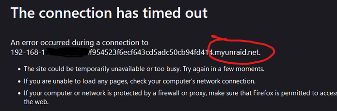

Reviving my own thread. This is still not solved. When I type my Unraid server's hostname in address bar of Edge, it takes me to the right URL but it ends there. What is blocking the GUI to show up, at this point?
Here is link to the error message on Edge.
https://imgur.com/a/rkppytE

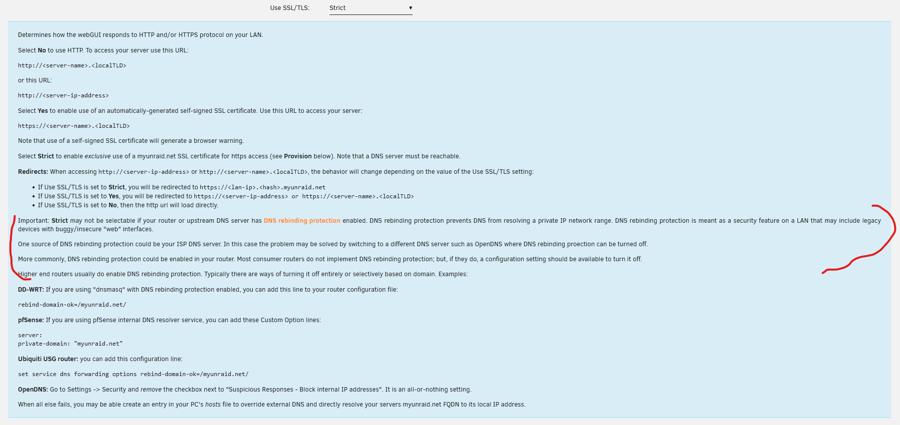

Screenshot from your screeshot:
From the 'help' in  SETTINGS   >>>  Management Access:
If this does not help, you will probably need to find the support group for pihole..
