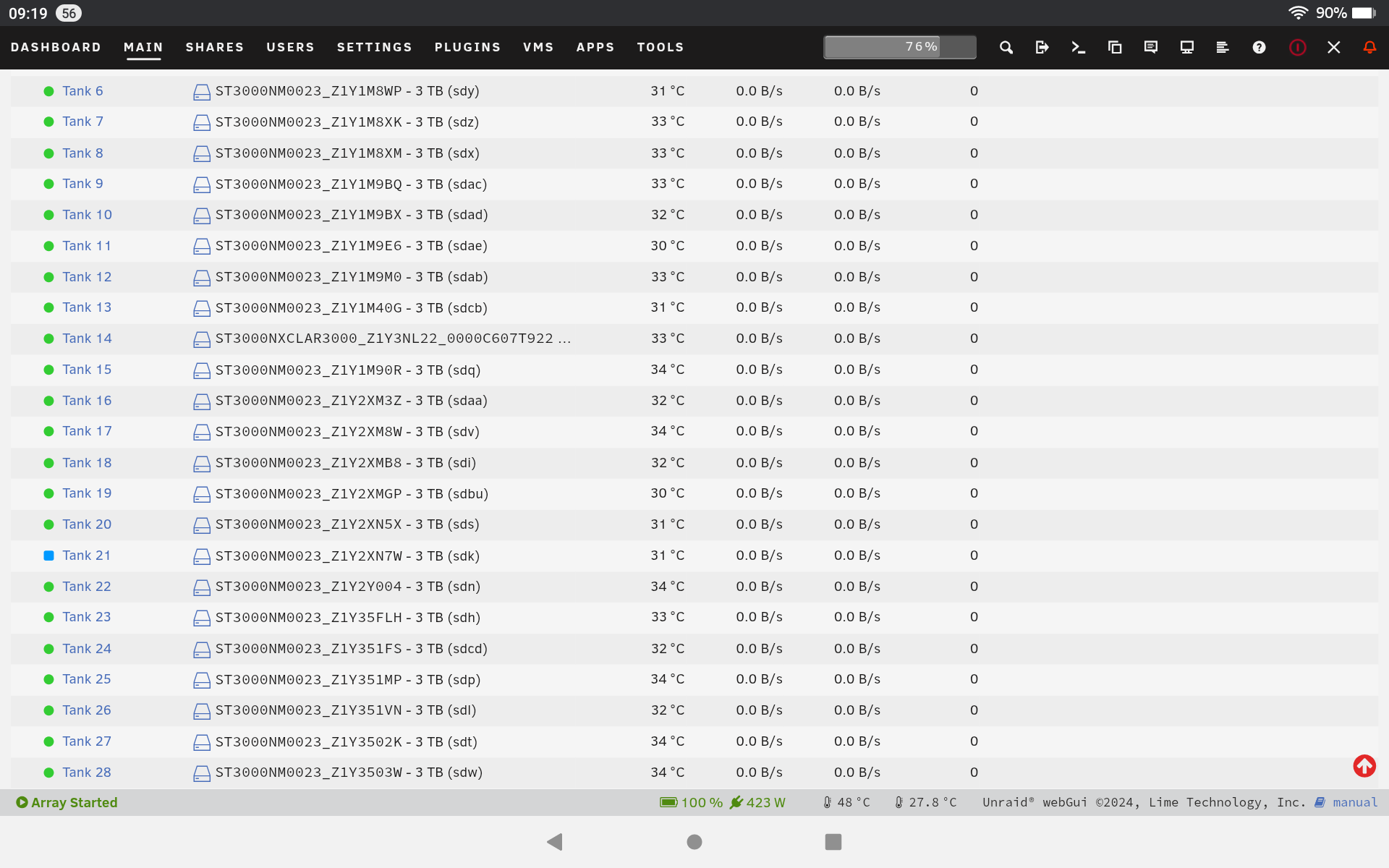

One of my zfs disks went offline and showed unassigned in gui config
I reseated the drive in the chassis and it came back online and was able to assign it in gui showed blue
Started array

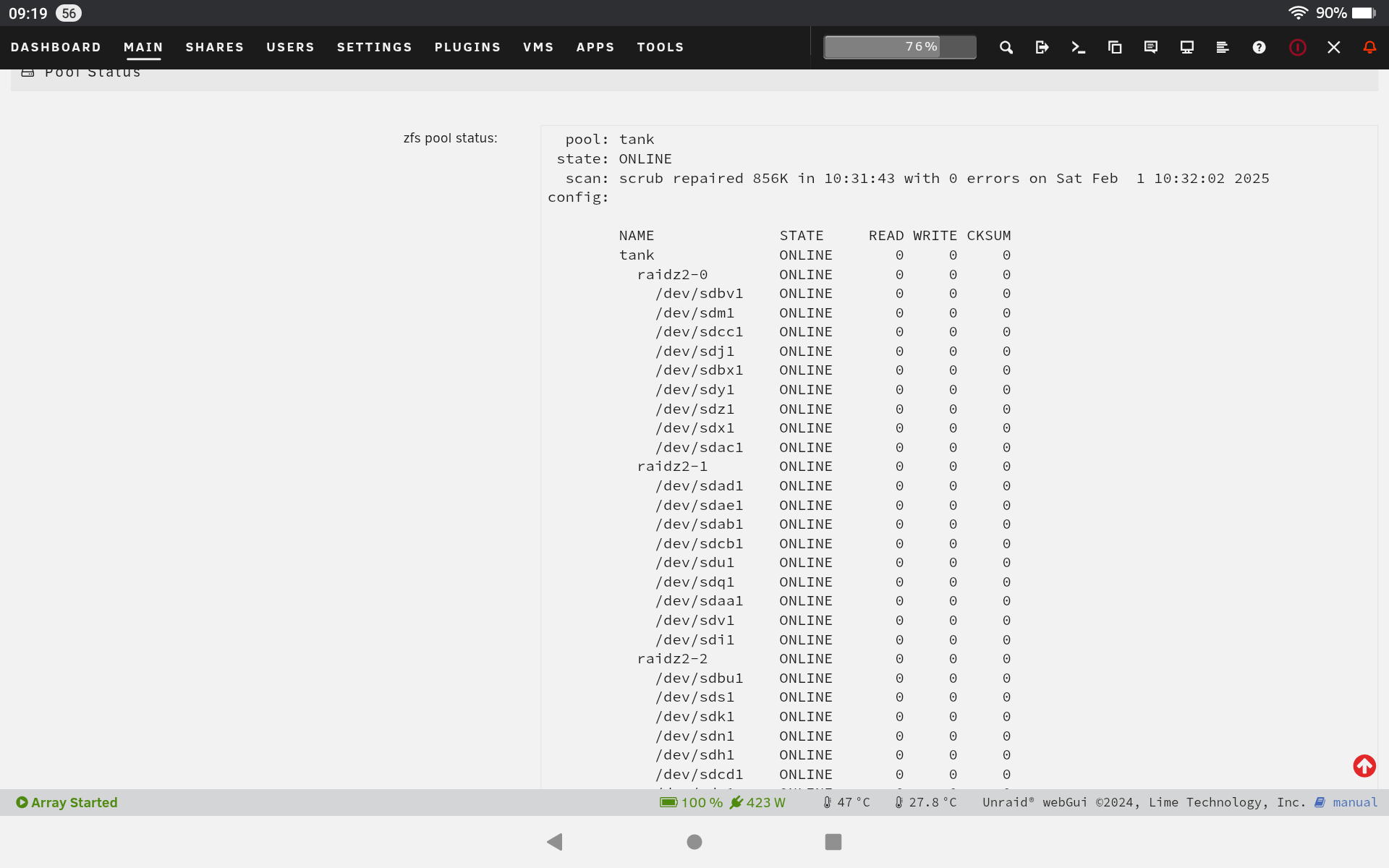

Scrub ran automatically and completely
Pool seems ok, all disks show online

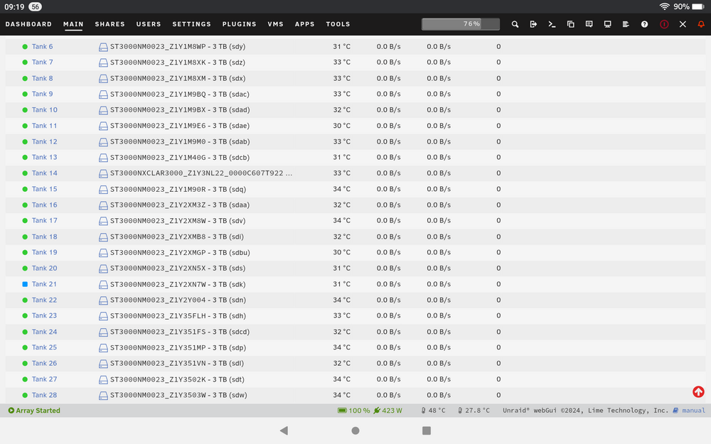

Disk still shows blue in gui, but everything seem to be ok
Shutdown, restart array and reboot did not clear blue status
Did I find a bug? Or do I need to manually do something?
