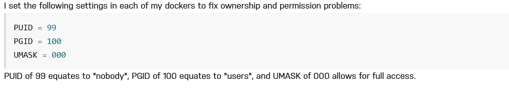

I am extracting this screenshot:
For security reasons, many Linux distributions (including Docker containers that are not developed for the Unraid environment) are now setting the permissions for files to 644 and directories to 755.  Unraid requires that for files to be shared via SMB that the permissions be 666 and 777 and the group  is 'users'.  Owner does not seem to matter unless it is 'root'.

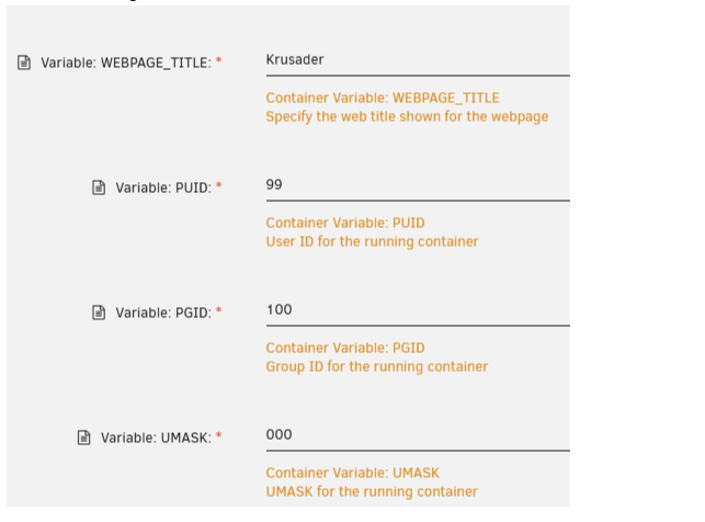

IF you need help setting things up, from this post:
          https://forums.unraid.net/topic/71764-support-binhex-krusader/page/38/#findComment-1486740
I am extracting this screen shot which shows how to add these three parameters (PUID, PGID, & UMASK) to your Docker Containers:
When you are editing your Docker Container, be sure to open up the 'show more settings' dropdown to see everything that is defined before you start adding any new variables.
