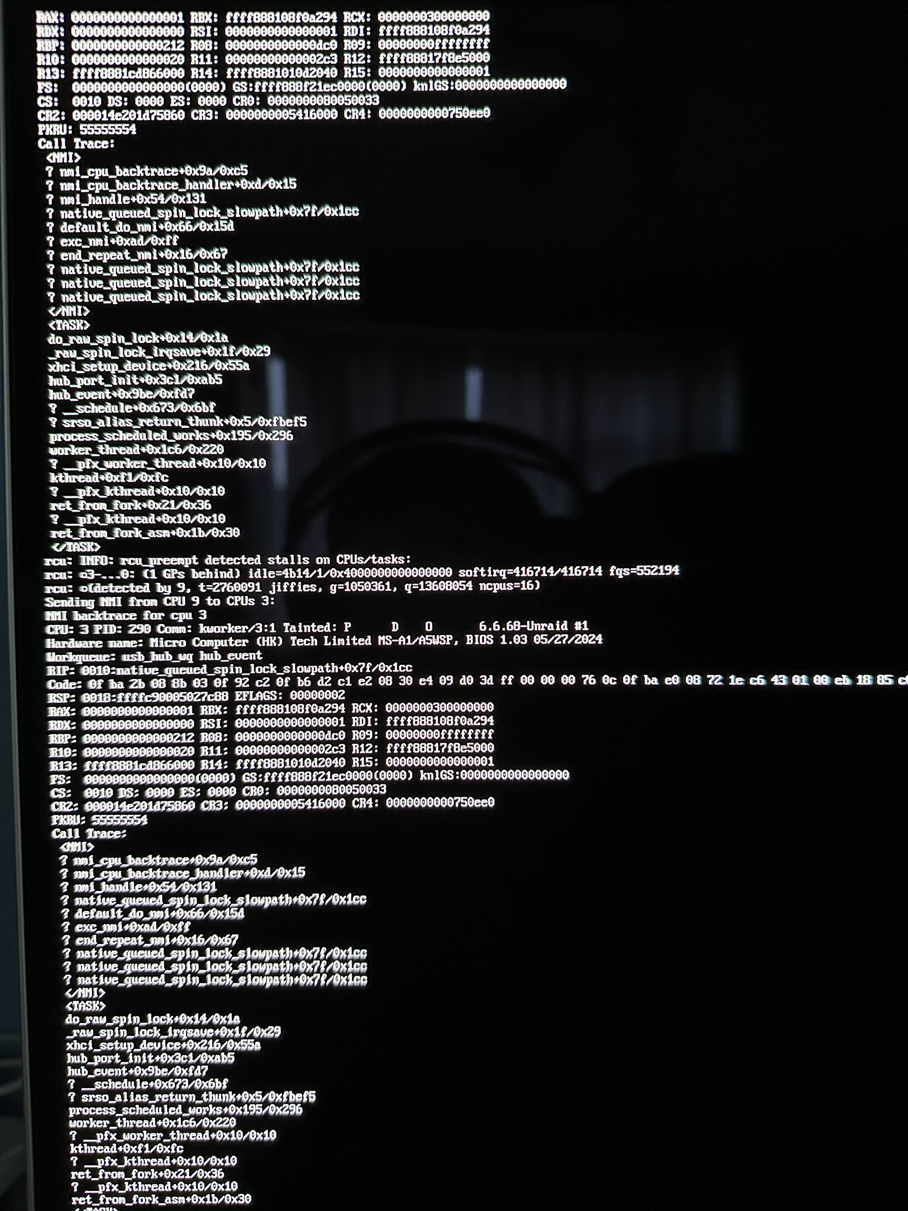

Hi I got the following error before I had to do an unclean shutdown as there was no other way around it afaik.
So what happens is it runs for a while, then i check back a little later randomly to try and log in via the browser and it just sits there are the log in screen in the browser. I then switch to the HDMI on the device since I cant login and get that out put as per the photo. I wasnt sure how else do get that info. I have attached the syslog. If there's other logs required I believe I have them. Im not sure what I need to do on how to resolve this.
This has happened 3 times since the last patch which is the only thing I can think of that has updated.
I have got the log filessyslog.txtIMG_0854.thumb.jpg.c06c8267dac54465c6613c2558202060.jpg

Seeing some USB issues with a couple of devices, but that should not crash the server, do you know the time it crashed?
