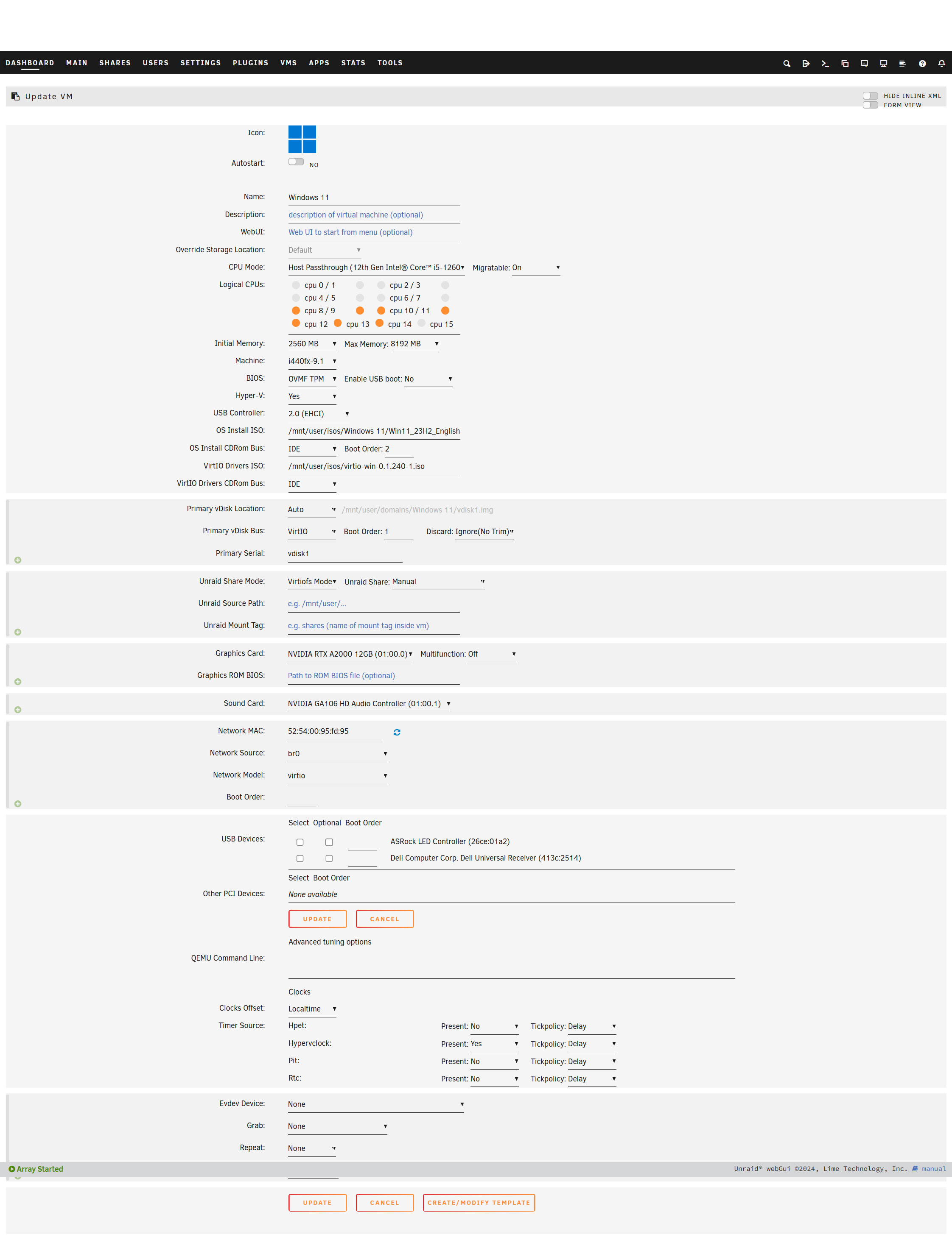

6.  The VM template is the following:
Thanks!

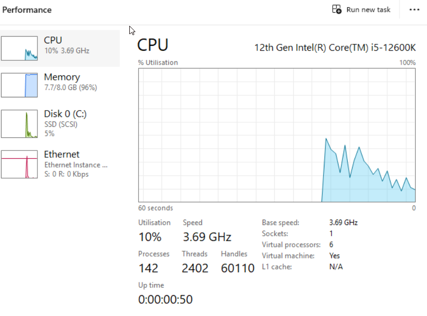

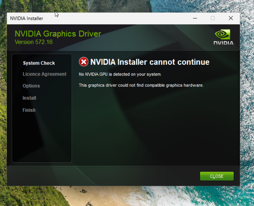

Hiya,
I tried to install the drivers, but they won't install as Windows isn't detecting the GPU when selecting VNC. I also tried binding the GPU, but still, nothing changed.
Am I doing something wrong here ?
Thanks again!

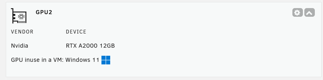

Make vnc the first gpu and A2000 the second in your vm config.
Then reinstall the nvidia drivers.

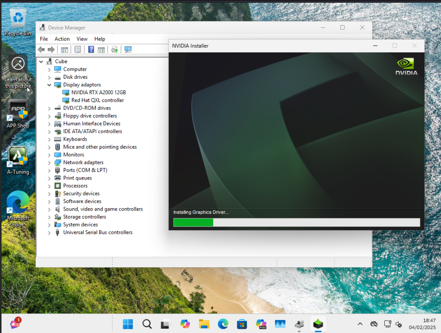

This is great! I didn't know this is possible... Getting there and now I can see the GPU! Thank you!
The only issue I have now is that every time I attempt to install the drivers, the screen gets stuck on the below:
Then it goes black and then gets stuck on this and the only way around it is to force shutdown ... and then same thing keeps happening
Did you have this issue when installing the drivers?
This is my XML just incase I did something wrong

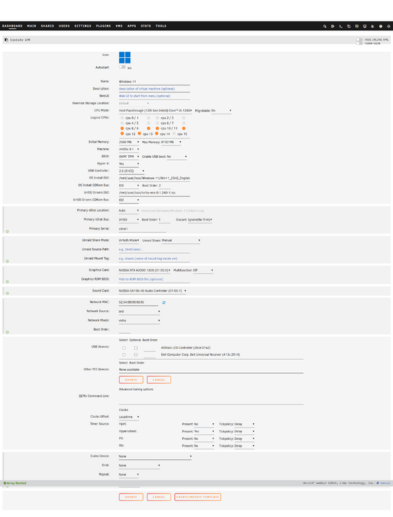

Create a new vm and use ISO image to test basic display output.
add maxphysaddr, I see a little difference with yours.
    <topology sockets='1' dies='1' clusters='1' cores='6' threads='2'/>
    <cache mode='passthrough'/>
    <maxphysaddr mode='passthrough' limit='39'/>
</cpu>
Start vm, If there's no signal, there are still some unknown issues in your unraid settings or vm template settings.
If you can see some ouput on your physical monitor, i think there's no problem with vm config.
Try to use Display Driver Uninstaller (DDU) to uninstall Nvidia driver with vnc(Graphic card set to vnc only).
Then edit vm config, set graphic card to your gpu only. Start and wait windows to autoinstall graphic drivers.
PS: when you restart unraid server, try to do a complete shutdown then press the power button. This can do a reset with your GPU card.
This is all the solutions I can think of so far. Good luck!

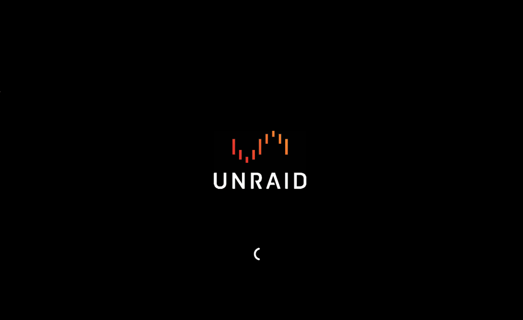

Hiya I tried all the options above but non worked.
I am getting black screen on VNC and no signal on the monitor that is directly plugged into the video card.

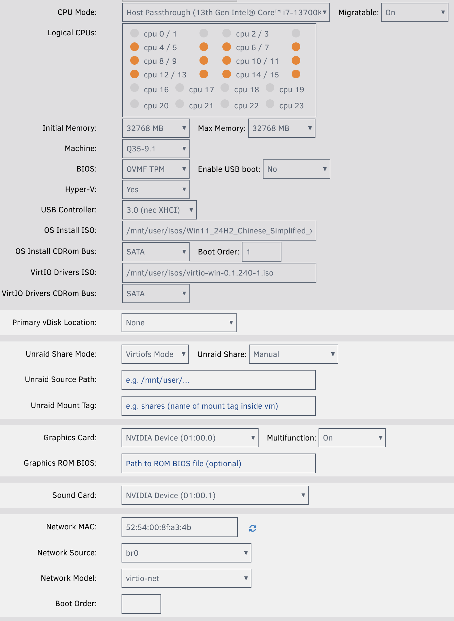

I started having this same issue this week as well.
Encountering the same as well. My setup and options are the same as OP, and while adding the maxphysaddr code, the VFIO_MAP_DMA errors disappear from the log, but there's no video output.
It seems that I'm not the only one experiencing this issue. It looks like the problem is related to the Unraid patch/kernel, but I'm unsure how to resolve it.
Does anyone have any other suggestions?
I am having this exact issue. Removing my GPU and only using virtual works just fine, as soon as I passthrough a GPU as a second Graphics card it gets stuck on that Unraid spash screen. Currently it is working with the machine set to q35 and a few minor changes to some random usb controllers I saw. Here is my xml in case it helps anyone:

On 2/4/2025 at 2:07 PM, neoherozzz said:
You can try this. It sometimes works.
add maxphysaddr to cpu block.
<cpu mode="host-passthrough" check="none" migratable="on">
    <topology sockets="1" dies="1" clusters="1" cores="6" threads="2"/>
    <maxphysaddr mode="passthrough" limit="39"/></cpu>
 This method is from this webpage.
Thank you so much for this tip and link!
I was going crazy with my gaming VM crashing under heavy load (e.g. DX12 titles with high/ultra settings). I have been troubleshooting this for weeks now and this finally seems to fix the issue :-)
For reference: I am using Unraid 7.1.2 with a RTX 5070 Ti and a NVME drive bound to vfio and passed through and 7 p-cores (isolated) and 4 e-cores (shared) of my i7-13700 for the Win11 VM. I also made sure that reBAR is enabled, TSC timer used by the VM, and some hyper-v parameters suggested in the forums. But the maxphysaddr final did the trick to stabilize the VM. Performance is superb!
Try removing the sound card, only passthrough the GPU.
