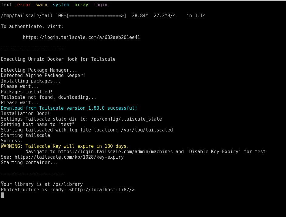

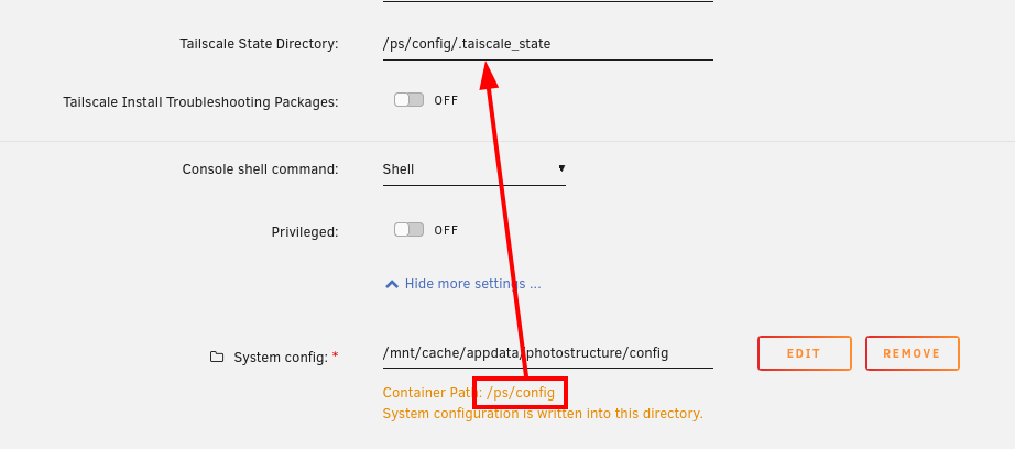

First of all the Tailscale state directory should be (/ps/config/.taiscale_state) :
I just tried a install from scratch and it works OOB over here:
