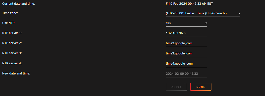

Post a screenshot from Settings - Data and Time, also the output from:

i hope you managed to fix your time servers in the meantime, because "_com" is not a valid domain. (i mean, i see what youre trying to accomplish but relying sole on one single one is a tat wild, get at least a second working backup one)
Edited by Mainfrezzer
That was an earlier user (OP) on this thread.
i know^^
