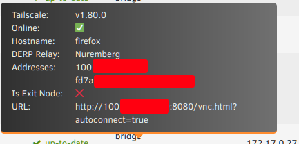

This is the first time that I hear of this issue, over here I can connect fine to other machines who are on my Tailnet who are running on other Servers which are using the Unraid Tailscale Docker integration with v1.8.0:
The docker run command alongside container logs would be also be interesting since if the Tailscale logo doesn't show up for you on the Docker page it usually isn't enabled.

Thanks, that's what I'm looking for to help further and for the Unraid Tailscale Docker integration v1.8.0 should work fine.
2 hours ago, ZacharySmith said:
There have been multiple issues posted on Tailscale GitHub which I linked.
Again, without logs and the docker run command I'm not able to help any further and why it is not working for you.
As you can see above it is working fine over here, if you even don't get the indicator on the Docker page when you enable the Tailscale toggle switch on the Docker page then there is something else wrong but I really can't tell without docker run and the container logs.
