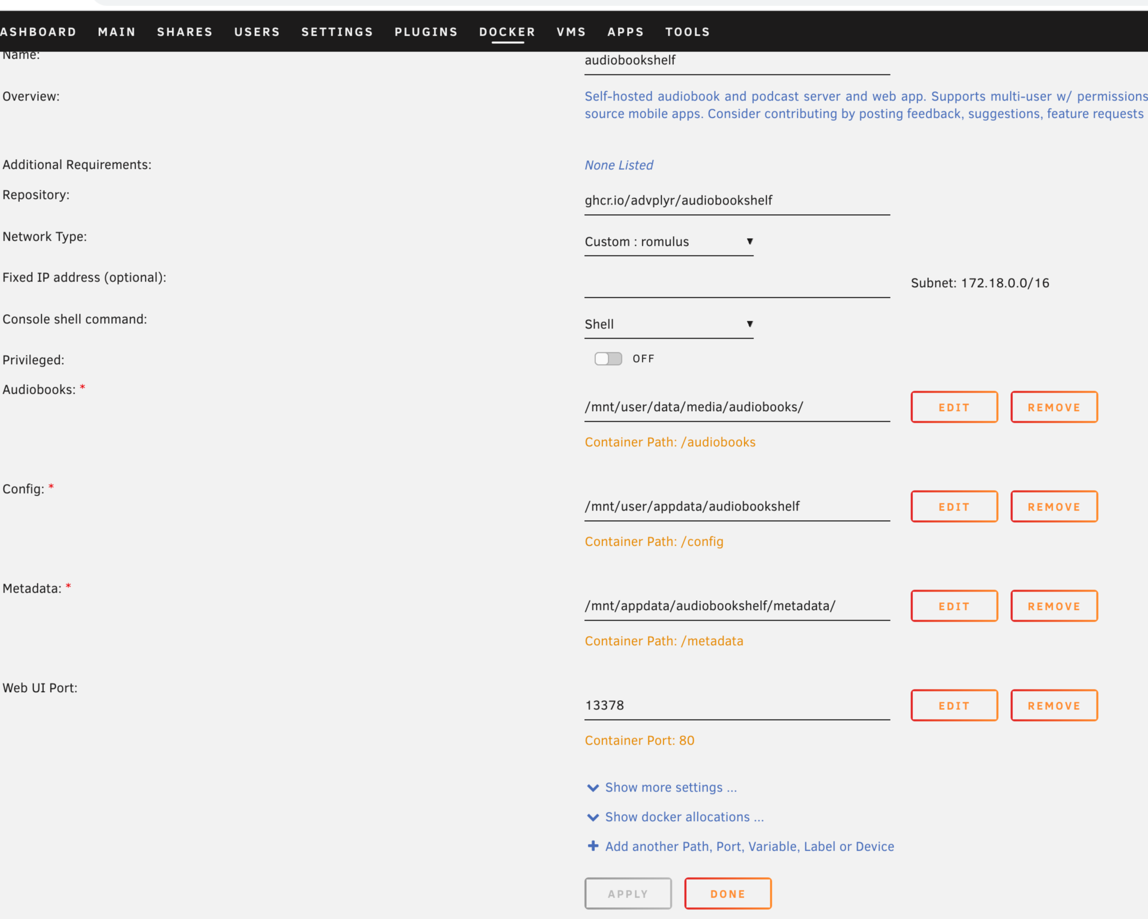

So for this the metadata path is just wrong?
yes, wrong. That will create
3 hours ago, nevincorn said:
Invalid folder appdata contained within /mnt
I assume you want it as a subfolder of that path you mapped to /config
I just took a look at that container, and that is what its template specifies, so you must have changed it to that invalid path.
