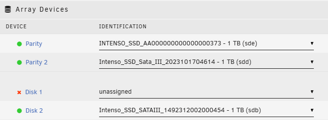

I have an issue with my unraid.
One of my discs got disconnected. Now it is shown as unassigned:
But it is still available:
If I reassign it, I get a message, that all data will be removed / overwritten once I start the array. So I didn't start the array.
How can I fix that the right way?
Solved by JorgeB
Disk was disabled, so it needs to be rebuilt, first start the array with disk1 still unassigned and post the diagnostics.

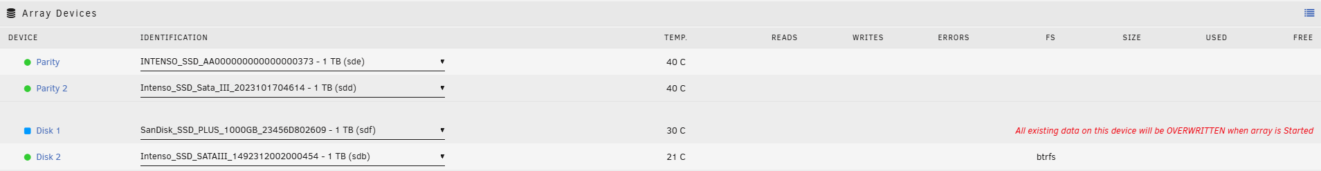

1 hour ago, JorgeB said:
Emulated disk1 is mounting, assuming contents look correct, you can rebuild on top:
How do I know if contents are ok? I can't look into it, can I?
You can browse the emulated disk contests, but since it's btrfs, and as long as it mounts, it should be all fine.

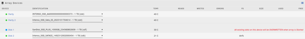

I followed the instructions. I reassigned the drive as said in step 6.
But now it is saying: All existing data on this device will be OVERWRITTEN when array is Started
And next to the Start-Button it says:
Start will start Parity-Sync and/or Data-Rebuild.
Did I follow the right steps and can proceed with the start of the array?
Yes, that's normal, since the disk wil be rebuilt.
Thanks a lot. Worked like a charme!
