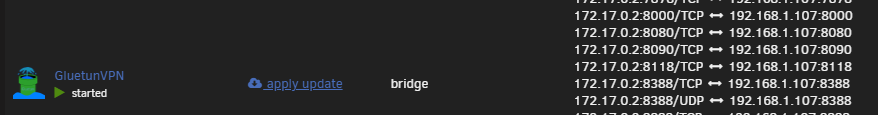

I run gluetun and run my *arr, etc programs through that docker.  One of the ports used is port 8000 seen here:
This is all on the bridge network or 192.168.1.0.  This all works fine.

For other containers when I use the br0.10 it works fine.  Is this caused by the port 8000 conflicting with gluetun?  The other containers use non-coflicting ports.  Like this;
Probably yes. What kind of network is br0.10
1 hour ago, lovingHDTV said:
Based on the above it looks like you are trying to make Spoolman available with a dedicated IP address rather than via the host IP. If that is the intent then you can just remove the port mapping from the template and Spoolman should be accessible via port 8000 at its IP address. The port mapping function maps a container port to a port on the host system for which there can only ever be one mapping per external port. Giving a container its own IP address exposes the container directly to the network making all its ports accessible without need for mapping.
