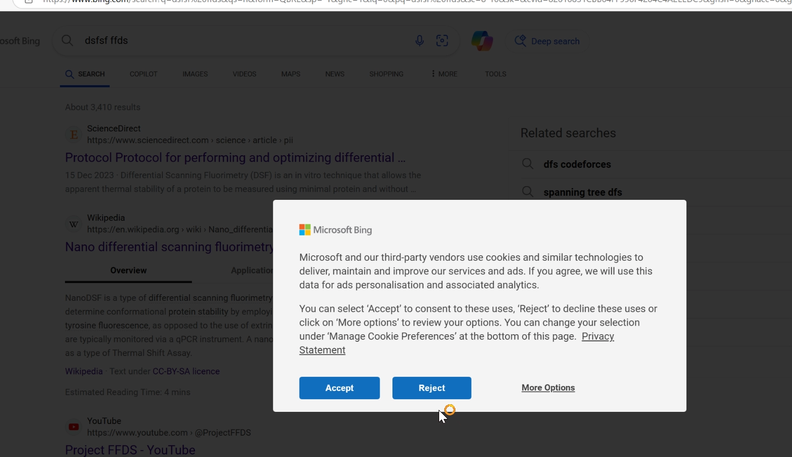

I get a yellow/orange wheel
Post a screenshot of that and the diagnostics after it happens.
Data as requested, checked the logs, apparently the vm is tainted? unsure what that's referring to?.
