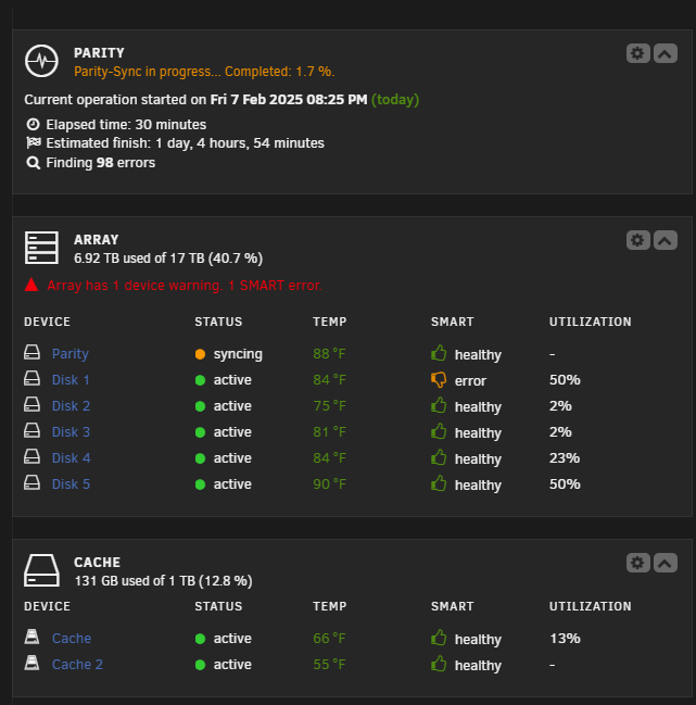

Parity-Sync in progress, can I revert?
I'm on 7.0.0 and did a parity drive swap.  Before the swap I had a zero error parity check and all drives healthy.  Now, as the parity-sync started, I have an array drive showing read errors.  Can I stop the parity sync and revert back to my original parity drive? Then I could replace the array drive. Do I just let it run?

Update: Parity - sync completed - 98 errors - One disk has SMART error

Disk1 has a pending sector, you can try to see if it can still be correctly emulated with the old parity, but keep the old disk1 intact for now.

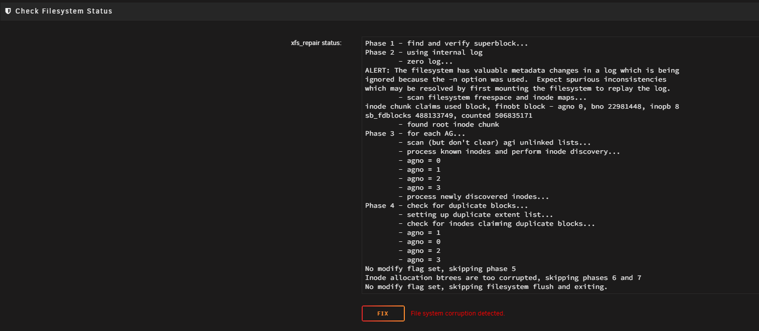

Do I press the FIX button?
Yep

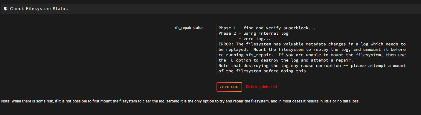

Okay, now I'm here.  Not sure exactly what this is this is telling me.  Can I just mount, somehow run the log, then unmount using Unassigned devices or do I need to stop the array, re-add disk1, run the log, then remove again?
Click Zero log, usually that's fine.

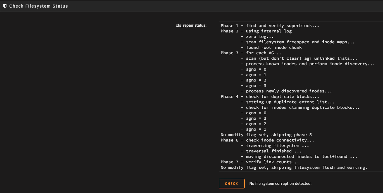

Restart in normal mode and the drive should now mount OK.

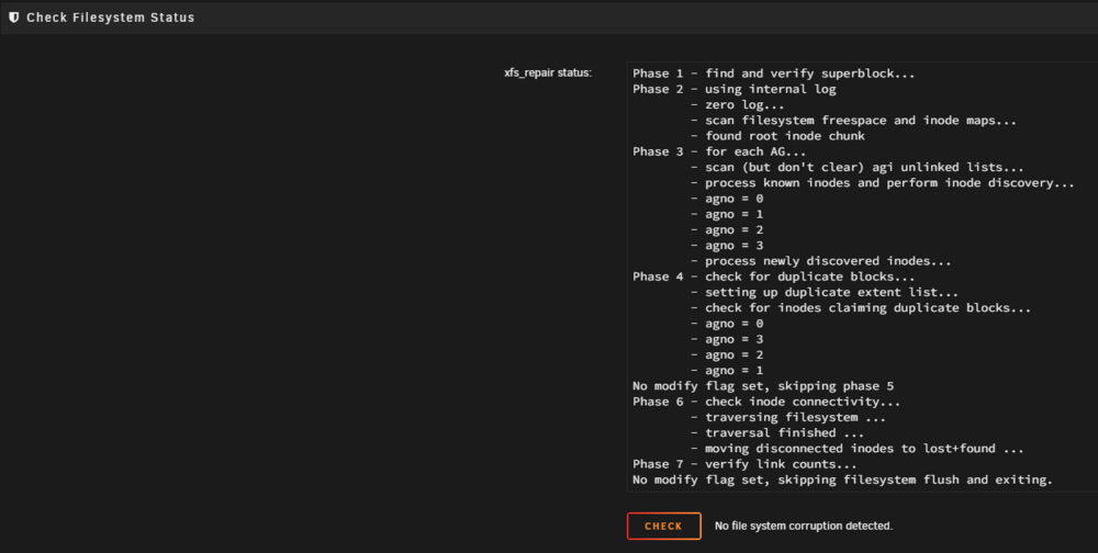

Okay now it appears I am back to square one, no errors and all drives show healthy. This is great so far.  I ran a short SMART test on disk1, the previously errored drive, and it completed without error.  I have the extended SMART test running and hope it runs fine.
