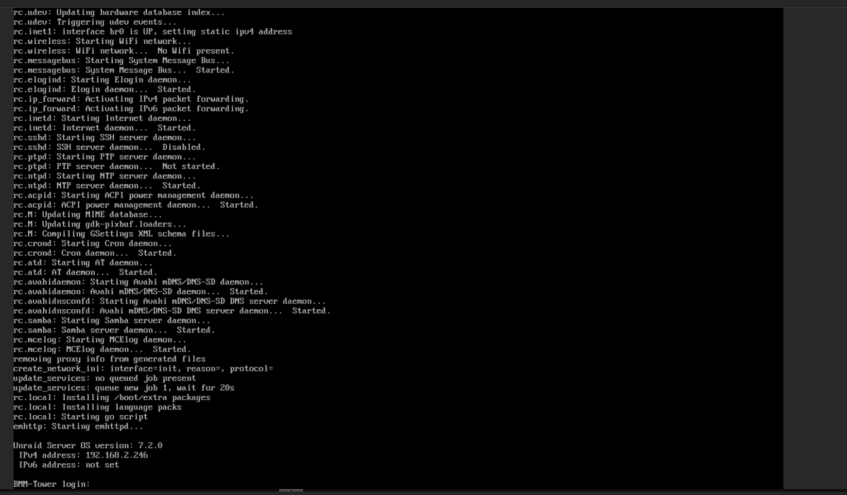

This was the output, when I logged in this morning via my KVM:
When I tried to reload NGINX e.g.:

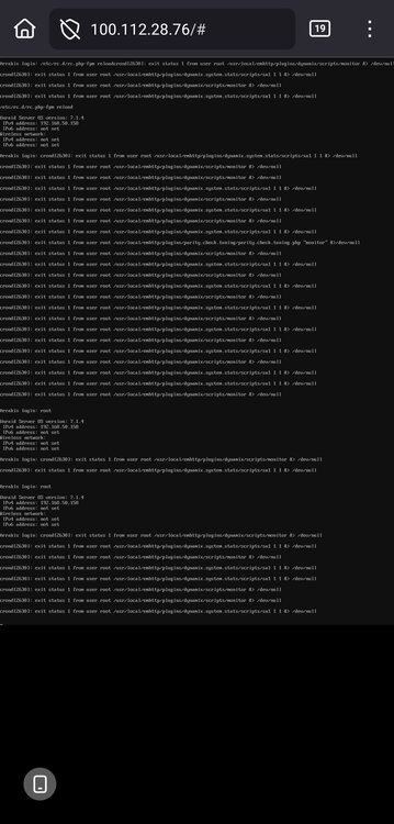

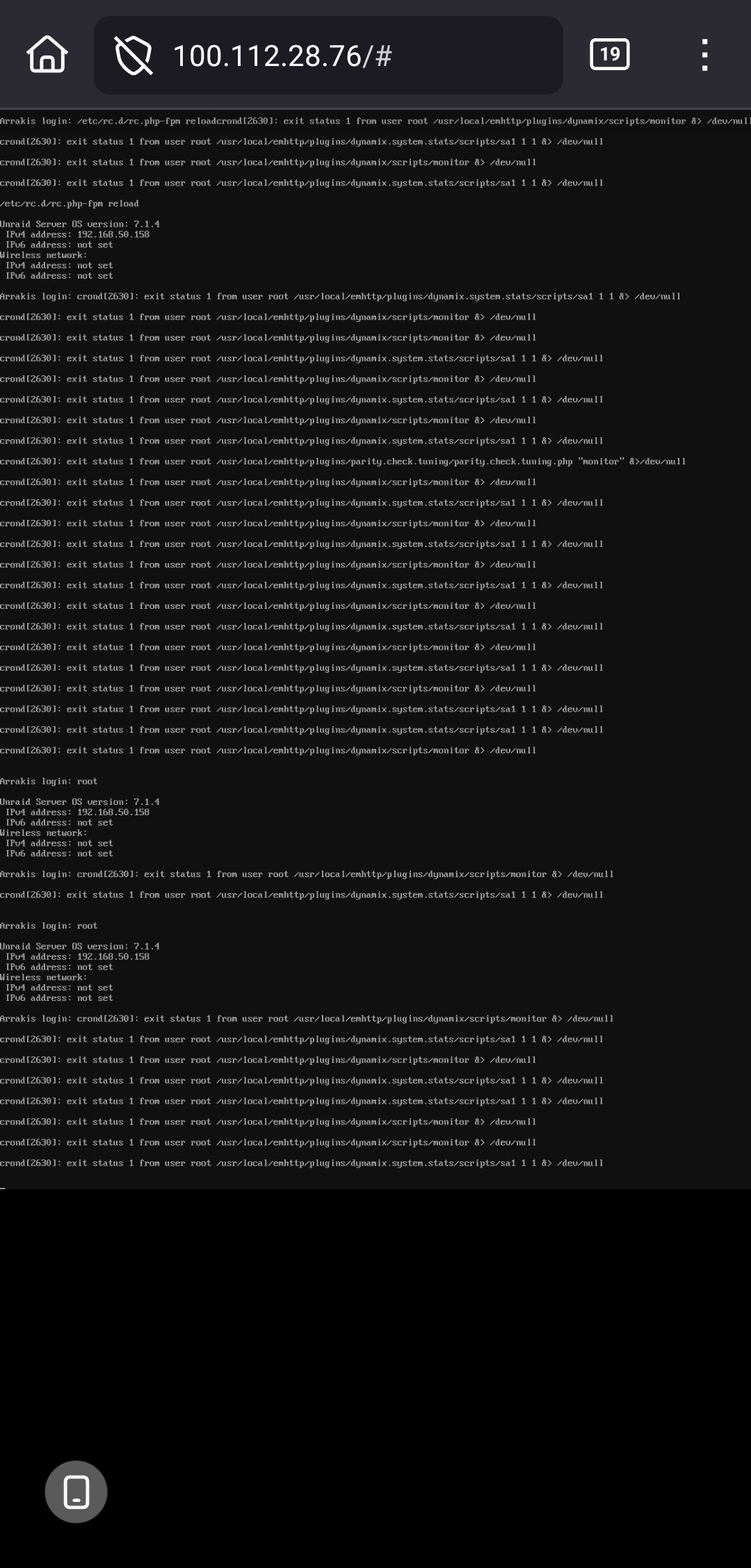

problem still occours, Server was not reachable anymore via Web, just via KVM.
This is what I got as an error message in the monitor:
When I tried to login it just logged in, then logged out directly:
As always: after a reboot its fine and I assume its fine for quiete some time now again.

I upgraded before the crash to 7.0.1, but did nto restarted.
Now after I restarted and 7.0.1 was isntalled I had the crash once again this morning with the same error.
Any chance to maybe create the monitor config from scratch? Otherwise I can post it here.

I just faced this issue on 7.1.4.
@squid
@squid
If you guys see this again, can you post the output of
ls -ail /usr/local/emhttp/plugins/dynamix/scripts

to hit this a runaway script may be running. we are trying to track the scirpt to kill the process and patch so it done't happen again.
not sure if its a 3rd party plugin or other unatentd bug or interaction.
I personaly haven't hit this error and can't reproduce it.
Otehrs claim it leaving it on the dashbaord on a browser over night that fills up and const refresh the script.
that comand as you see list the scripts active and curenlty running for squid and other devs to take a look and inspect.
I'm seeing alot of WG, Reversproxy and other runing whcih coould cause the connections over them to hist the memory cap and connt load of the emhttp page...
I'm not saying its the vpn... but @UnraidTobias yor line shows.
6986 -rwxr-xr-x 1 root root 2304 Feb 5 2024 wg_config*
6964 -rwxr-xr-x 1 root root 3390 Dec 17 2024 outgoingproxy*
is showing mutiple vpn scripts running...
where @Joloxx9
your lines don't...
and we can compare on a healthy sytem what scirpt doen't belong and whats still running that might cause this error...

I can confirm that system was running in my case for 30 days+ and I left 5 windows of unraid open on my machine and left it for like 16 hours, at 23:30 all was good but system crashed right before midnight.
I could still access containers through IP:port
Nginx reverse proxy was not working
CF tunnel was down(even that all containters were running)
I could not SSH to the server - connection refused
I could not log in directly on the machine as you can see on above screenshot, putting anything as login was doing nothing.
After restart from the button(thank god for KVM!) all is back an running, minus 30hours for parity check -.-

@Squid The problem is back
I expierence again the same problem since I upgraded to 7.2.0. My Server/Machine was stable since Mid may. Back then I thought it was a USB port causing the problems and switching was helping.
When I upgraded to the latest stable Unraid Version, which I did it via my mobile phone. There were no other PCs running with the webinterface, so this means the option with
