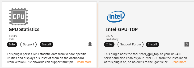

I think the dashboard showing the HD730 would be fine with the install of these 2 plugins:
as passing to plex and using the transcode shouldn't be a issue as long as the host sees it...
and the hd730 vs 770 are close Enouth for a chipset in use comparison?
