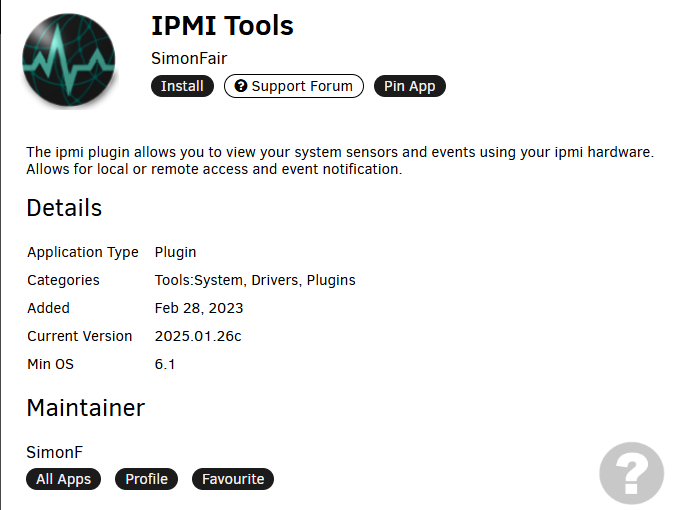

for what board.
I have had luck with just installing the plugin:
otherwise, you may need to factory reset your ipmi via linux terminal:
"ipmitool mc reset cold" which will initiate a cold reset of the BMC (Baseboard Management Controller) via IPMI (Intelligent Platform Management Interface
as user shinji257 is rebuilding and maintaining the packages for nerd tools.
you can install the latest binary from their repo:
https://github.com/shinji257/unraid_pkgs/tree/main/slackware64-current/ipmitool
