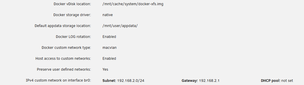

I use macvlan. Since adguard home is a networking tool. I'd recommend you use macvlan as well as macvlan will give the docker a separate mac address which can assist in some communications...
Web UI > Setting > Docker:
In your case you want option Host access to custom Networks enabled.
next we will take a look at your docker network settings...

As I have my own and run custom docker networks... If You want to add others, You should enable the option Preserve User Defined networks.

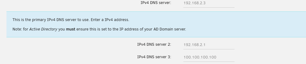

With the array off You may want to specify custom dns settings:
It is recommend to have your router gateway, and a public IP you trust examples. google 8.8.8.8, open dns 208.67.222.222, cloudflard 1.1.1.1
Ad Guards was nice enouth to collect and help with known public providers:
https://adguard-dns.io/kb/general/dns-providers/?utm_campaign=dns_kb_providers&utm_medium=ui&utm_source=home
100.100.100.100 is tailscales public dns...

Thanks for your help this are my docker settings
Not sure if there is something obviously wrong. Also not sure why AdGuard tries to listen on 172.17.0.1:80 also why does it activates at a weird address

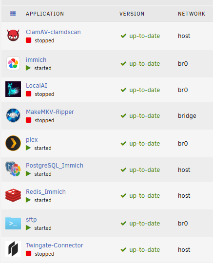

edit your adguard and set the docker network to custom and giv it a ip of 192.168.1.254
as the ip:

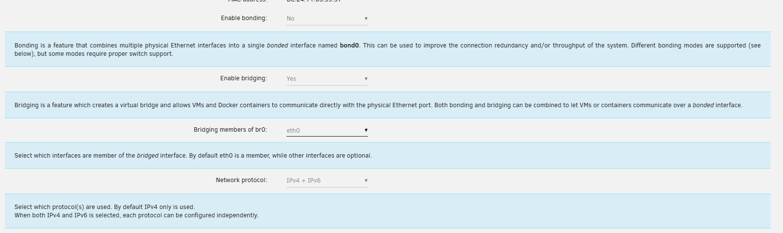

your adguad is set to docker bridge mode and need to be set to a static IP on the subnet. if set to custom and still seeing that ignore the 172.x.x.x address as it is looking and docking as it should on unraid as it is broadcasting over unraid and into the docker default network for dns names. It is better to have it set to a custom br0 network and a static IP
edit the docker and set the network to custom br0, eth0, bond 0 (depending on your unraid network settings...)
Set adguard to use a custom IP: Example
set a static custom IP:
