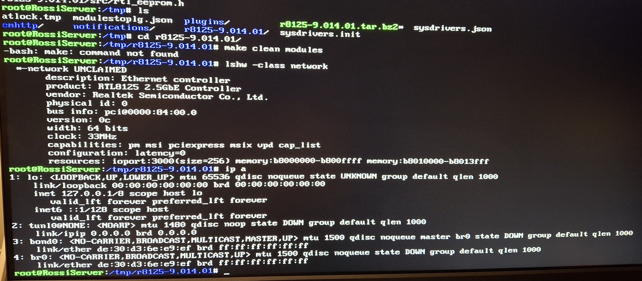

Now i have IP ADDRESS: not set , so i cant connect by web gui or use internet on the device, but i can login manually with the terminal
from what i can tell the eth0 doesnt exist since this mb has a bonded lan which is causing the issue.
the network is seen, but UNCLAIMED. I tried manually setting the DCHP to No, and setting my own ip address but that didnt work.
I tried modprobe r8125 but it didnt work, so i downloaded the realtek driver but cant make it now.
can i download some package to use 'make' manually on a pc and transfer by usb to the server like i did the realtek drivers, or is there anyother way to install the drivers. (using the bios? )

Feb 10 07:26:40 RossiServer kernel: r8169 0000:84:00.0: error -ENODEV: unknown chip XID 688, contact r8169 maintainers (see MAINTAINERS file)
NIC is too new for the kernel, will need to use a different one or wait for a newer Unraid release.
