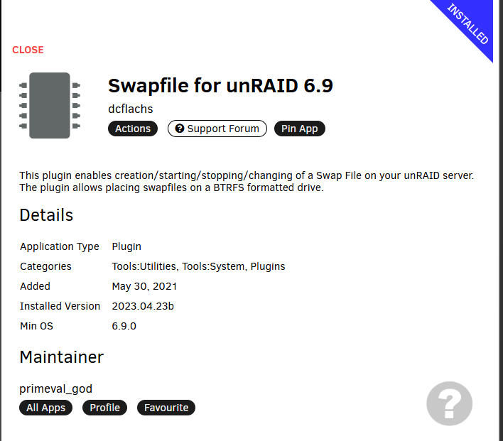

If you have a btrfs cache disk. I also recommend installing and running the swap file plugin.
I do have a btrfs cache, but the only swap file plugin I see is called "Swap file for Unraid 6.9" and I run 7.0, would it still work?
yes, it works on 7....
But that plugin requires a btrfs disk to use as a swap file/disk
this is the plugin I was referring to:
Edited by bmartino1
Okay, thanks for the clarification. I'll install that and see if that does anything. I think I'll also look into upgrading my server memory, my 16GB is probably just getting to be not enough anymore.
