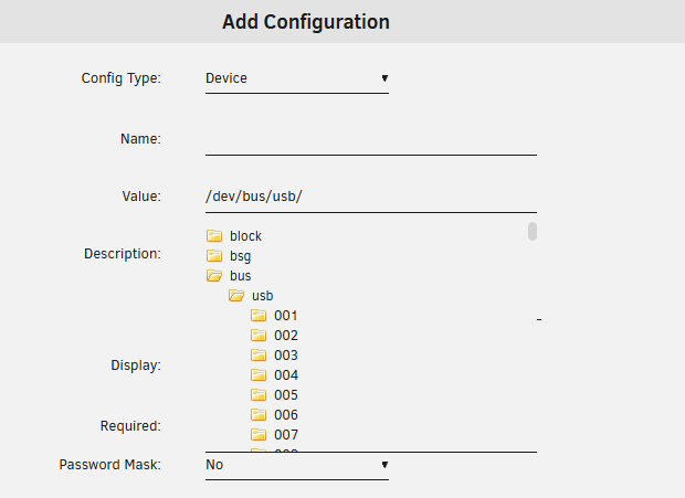

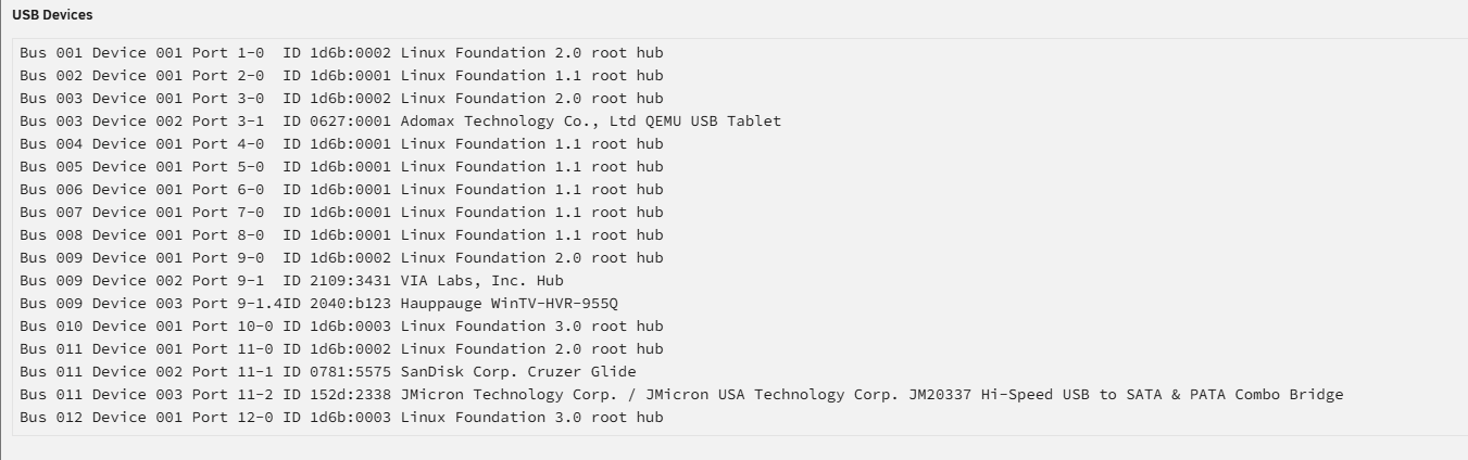

You need to make sure your grabbing the correct device and all its sub devices:
as example:
Some devices may need extra parm options, if full bus pass is not working you may need to pass this and look into passing via its serial ID.

devices:
- “/dev/bus/usb:/dev/bus/usb” # Mount the entire USB bus

you can list your current devcie with this command:
ls /sys/bus/usb/devices/
example:
ls /sys/bus/usb/devices/11-2/
echo '11-2' | sudo tee /sys/bus/usb/drivers/usb/unbind
will touch my usb attached disk driver. then unmount the entire usb port, making it easer to mount and rebind elses where.
You can get more info with command:
udevadm info -q property -n /dev/bus/usb/$BUS/$DEV
*replace Bus# and Dev#

with unraid v7 we have access and can use udev rules...
mkdir /boot/config/udev
touch /boot/config/udev/99-serial.rules
You can then make a udev rule that is applied at boot...
