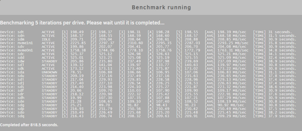

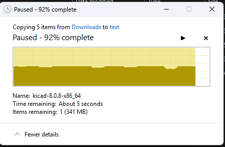

Screenshot of a 5-file transfer. Nice and solid.

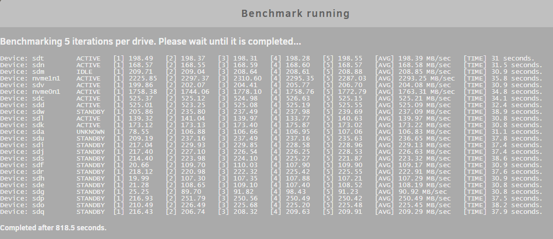

This is a benchmark from the DiskLocation plugin

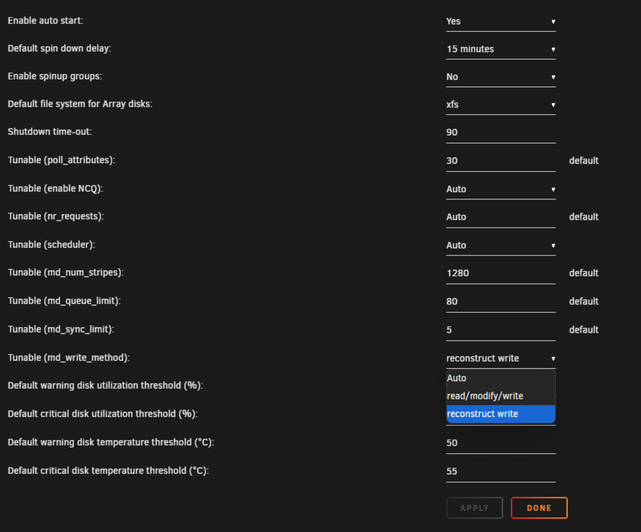

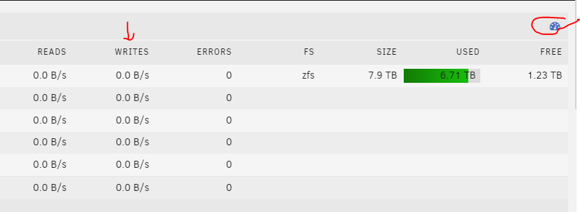

If the transfer wasn't large enough it could have been cache to RAM, check the actual array write speeds during an SMB transfer, you can toggle that in the GUI:
What speed do you see there?

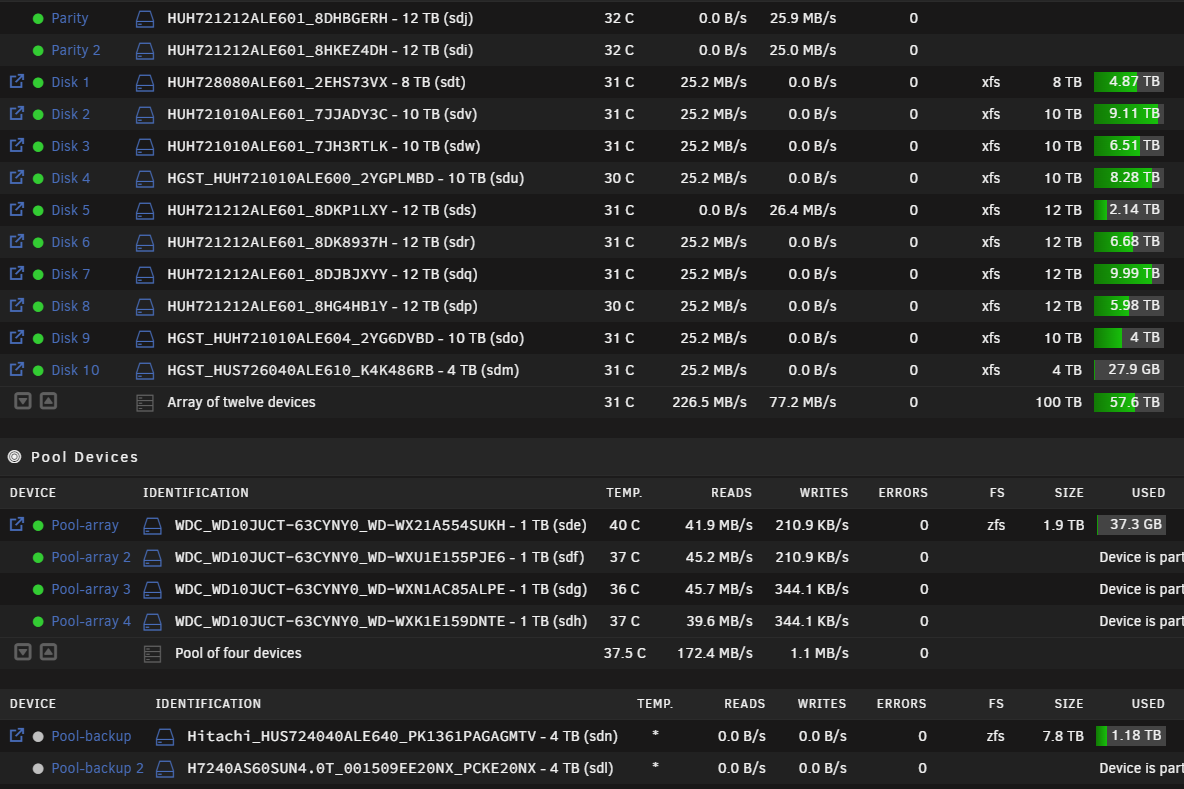

I always have the speed showing. That's how I know it's going slow. This photo is pretty normal for what I'm seeing all the time. The only thing running is Mover.

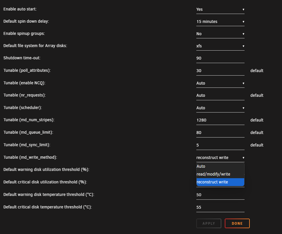

3 hours ago, JorgeB said:
Turbo write is not enabled.
That is one of the first things you told me to set, which I did.

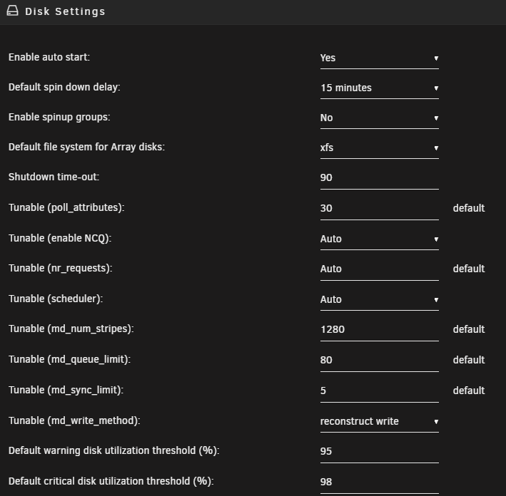

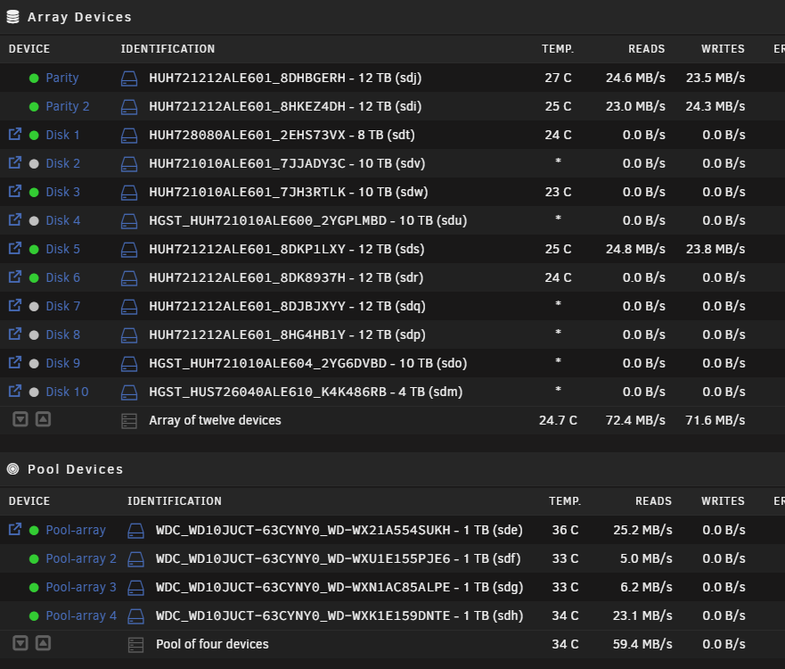

But, here's a screenshot after you asked for another one. Turbo write IS enabled. CA Turbo plugin removed. No other activity. Here's another screenshot of the disk settings, as well, and for good measure, yet another diagnostics.
neo-diagnostics-20250216-1136.zip
Turbo write is enabled in that screenshot, but it's still slow, there appears to be a hard limit at 25MB/s, like if write cache is disabled, which also doesn't look like the problem, sorry but no more ideas, this would require more drastic testing, e.g., remove one of the parity disks and test its write speed outside the array, if normal test the other one, and the disk be written to.

Both parity drives were individually speed-tested with the DiskLocation plugins Benchmark tool. Both drives were comparable with the identical 12Tb drives in the array.
It only test the read speed, not the write speed, which is the problem here.
