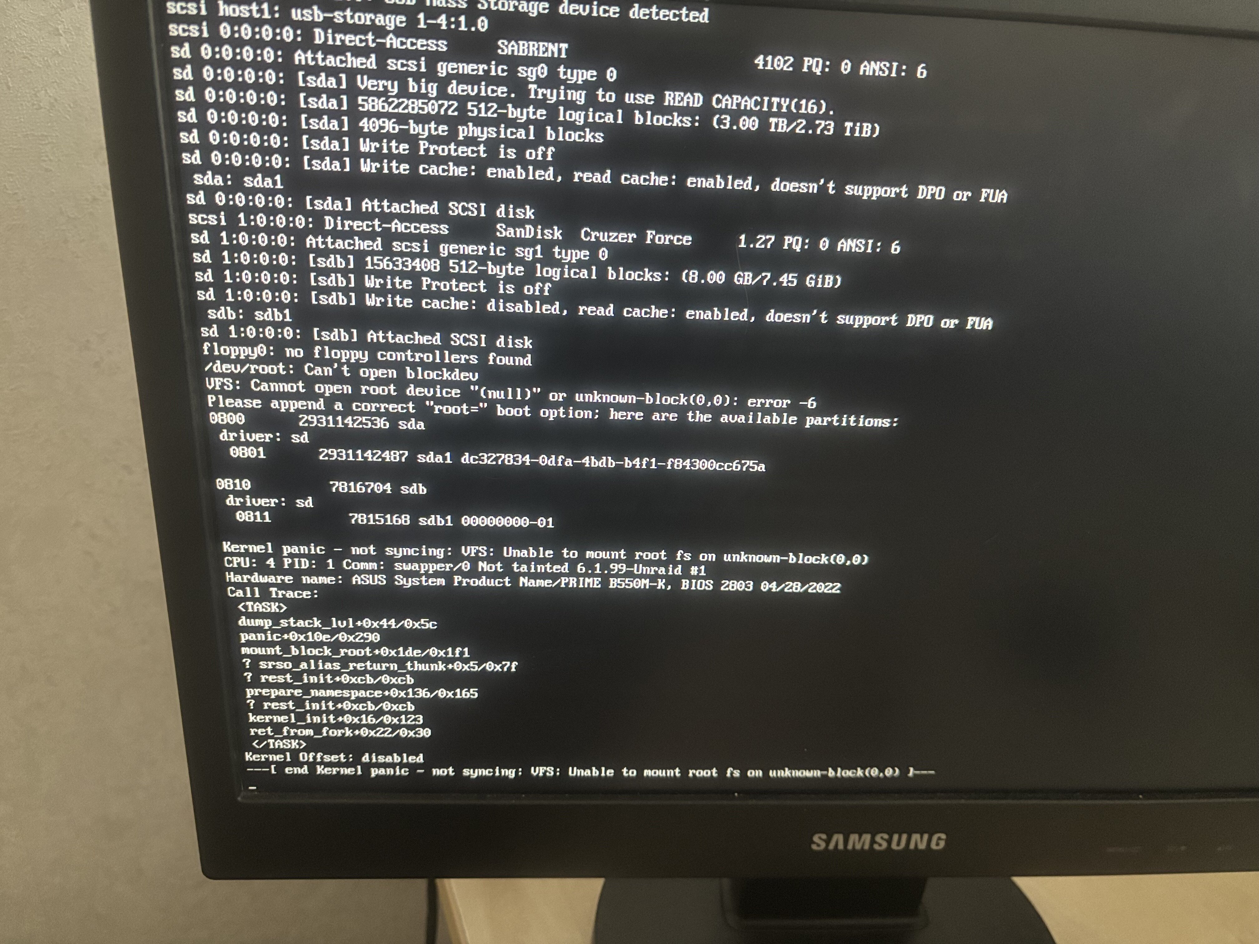

Hi, i am looking for some advice on how to reload unraid .
 I rebooted the system and took over 10 minutes to reboot and when it finallly tried to load it failed to complete the installation with the errors.
As I am a newbie i am unsure what the proiblem is and how to fix it .
 On the image it is showing errors  Cannot  open root device  etc.
Any help or advice would be appreciated .
Solved by JorgeB
Try recreating the flash drive, first backup the current one, then recreate it using the USB tool, confirm the flash drive boots with the stock install, and if yes, restore only the /config folder from the backup overwriting any existing files.

 Thank you worked a treat
