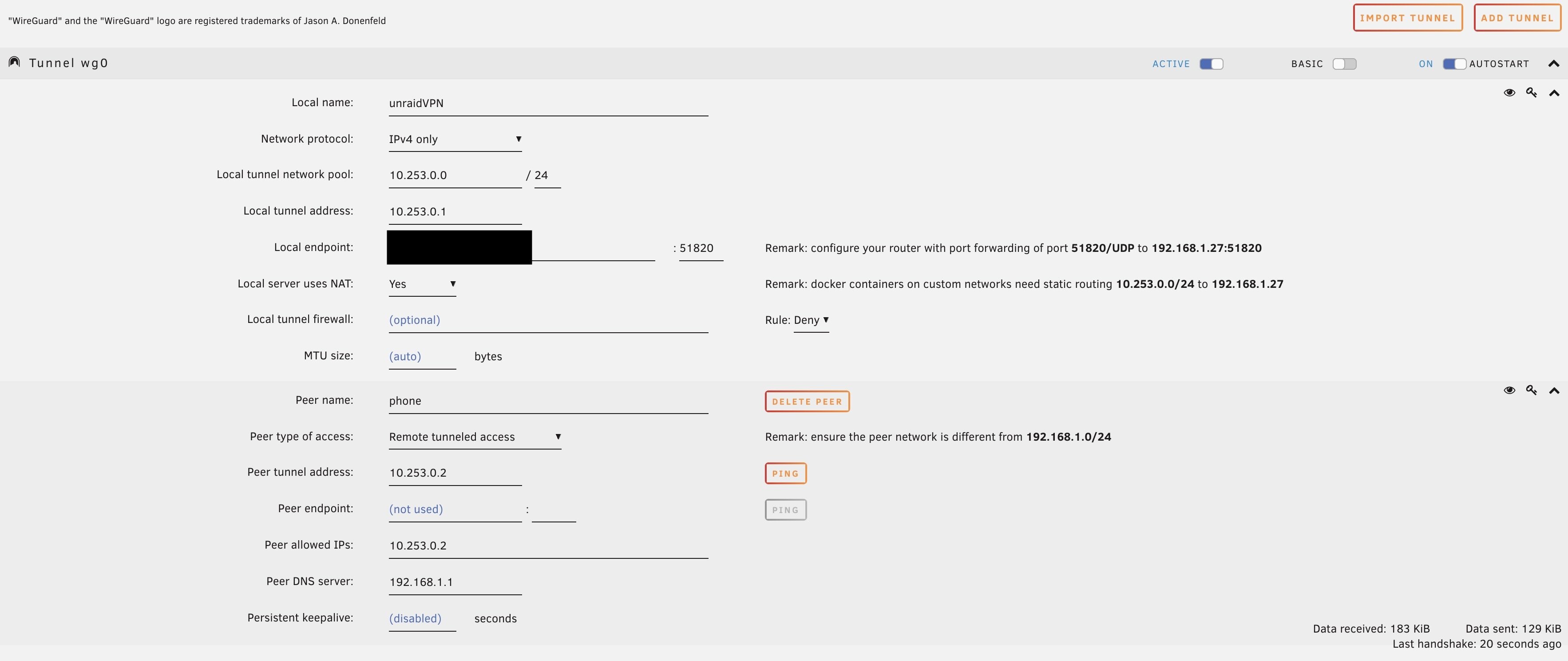

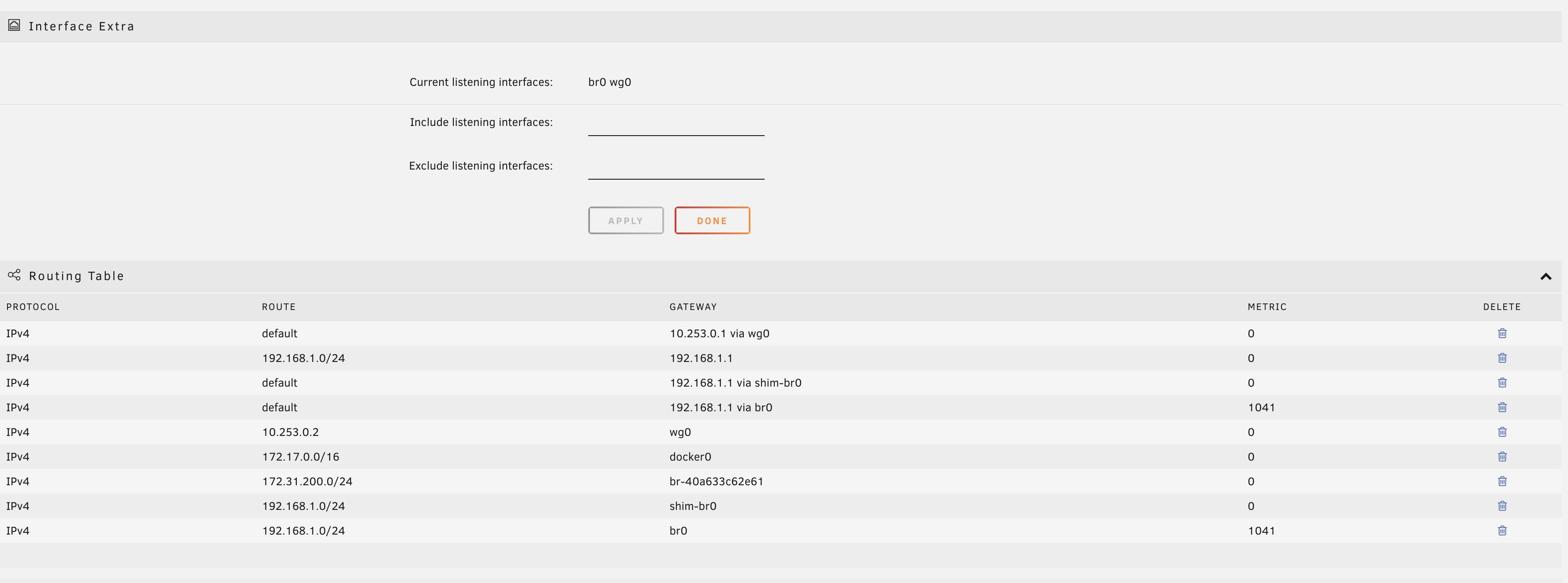

I have a WireGuard tunnel on unRAID set to “Remote Tunneled Access” (with NAT enabled). My phone successfully connects (I can reach my unRAID share on 192.168.1.27), but all Internet traffic and access to 192.168.1.1 fails. Traceroutes stop at 10.253.0.1, meaning unRAID isn’t forwarding traffic onward to the router.
Basic Setup:
unRAID WireGuard: “Remote Tunneled Access” + “Local server uses NAT: Yes”
Phone client: AllowedIPs = 0.0.0.0/0
Symptoms:
SMB shares on 192.168.1.27 work.
Router web UI (192.168.1.1) times out.
Pings to public IPs (e.g., 1.1.1.1) fail, tracert only shows 10.253.0.1.

root@atlantis:~# cat /etc/wireguard/wg0.conf
[Interface]
#unraidVPN
PrivateKey=xx
Address=10.253.0.1
ListenPort=51820
PostUp=logger -t wireguard -- 'Tunnel WireGuard-wg0 started';/usr/local/emhttp/webGui/scripts/update_services
PostUp=iptables -t nat -A POSTROUTING -s 10.253.0.0/24 -o br0 -j MASQUERADE;iptables -t nat -A POSTROUTING -s 10.253.0.0/24 -o vhost0 -j MASQUERADE
PostDown=logger -t wireguard -- 'Tunnel WireGuard-wg0 stopped';/usr/local/emhttp/webGui/scripts/update_services
PostDown=iptables -t nat -D POSTROUTING -s 10.253.0.0/24 -o br0 -j MASQUERADE;iptables -t nat -D POSTROUTING -s 10.253.0.0/24 -o vhost0 -j MASQUERADE
PostUp=ip -4 route flush table 200
PostUp=ip -4 route add default via 10.253.0.1 dev wg0 table 200
PostUp=ip -4 route add 192.168.1.0/24 via 192.168.1.1 dev br0 table 200
PostDown=ip -4 route flush table 200
PostDown=ip -4 route add unreachable default table 200
PostDown=ip -4 route add 192.168.1.0/24 via 192.168.1.1 dev br0 table 200
[Peer]
#phone
PublicKey=xx
PresharedKey=xx
AllowedIPs=10.253.0.2
Edited by atlantis4547

I was finally figure it out from here https://docs.unraid.net/unraid-os/manual/security/vpn/#complex-networks , It seems I was not looking to the latest docs earlier. The youtube videos and reddit dint really mention these setting at all.

i bet you have host access to custom networks enabled
Edit: well duh, you do, the screenshow shows it xD
Edit edit: just tagging you @atlantis4547
Edited by Mainfrezzer
