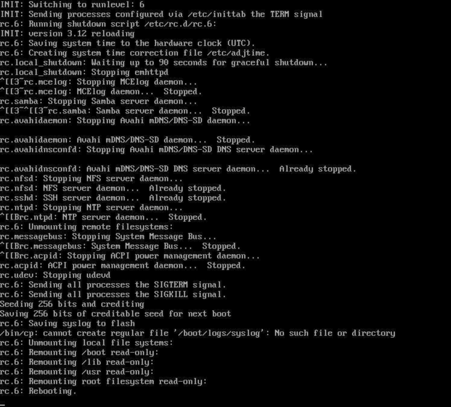

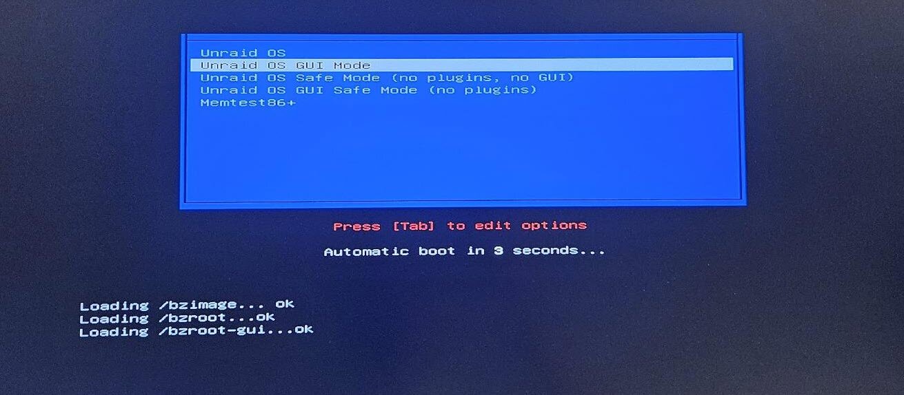

As you can see in the screenshot the system freezes when picking Unraid OS GUI Mode.
I just made a fresh flash disk. At first it worked, but after a reboot this happened.
Is this after the OS is loaded to RAM?
How can I know if there is something wrong with the flash drive? It's a Samsung FIT Plus - 64GB so it should be of decent quality. But I have used it for a year.
Steps to reproduce:
  1. Make an Unraid 7 flash disk with "unraid-usb-creator-1.0.1.exe".
  2. Boot from the device.
  3. Select Unraid OS GUI Mode
  4. Notice how the system freezes.

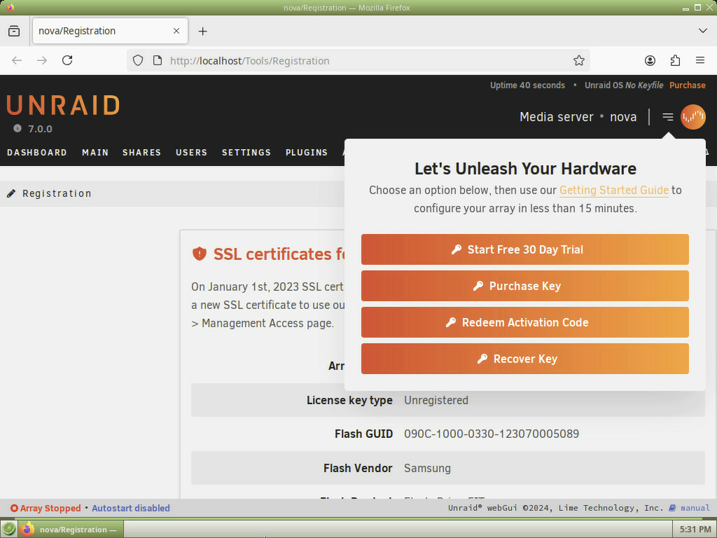

  • Now it is complaining about SSL certificate for unraid.net being deprecated.

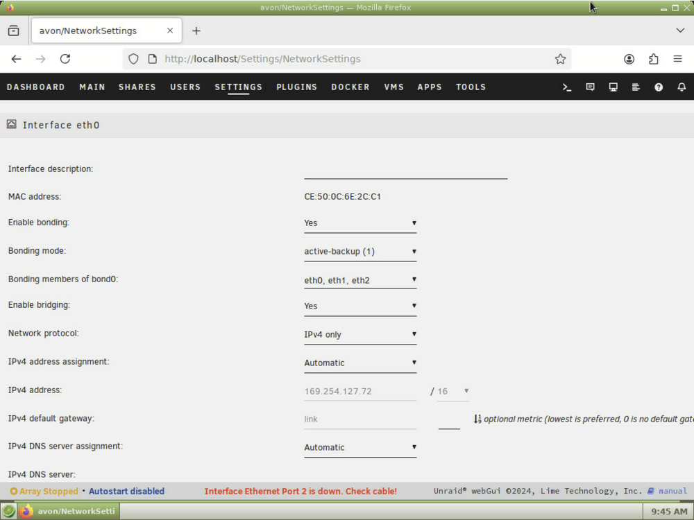

  • I go to Settings ➜ Network: Now it says "Interface Ethernet Port 1 is down. Check Cable." even though the computer is connected to the router.
Try another cable or port.
I changed the cable and changed the port to the other Intel 2.5Gb Ethernet port. The server still does not appear on my router even though the LAN LED indicator is green (indicating that it is linked).
Check the server date and time.

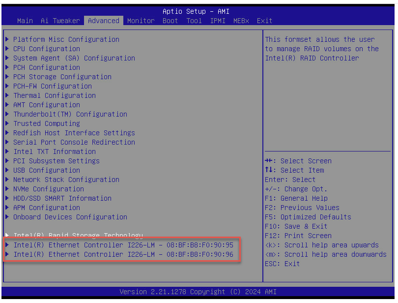

If I boot into BIOS this is what it says:
However both says:
I have literally no idea what is going on. I am so lost.

It's an issue with the virtual NIC, the solution is to blacklist the driver, but if you don't mind, try this first to see if it also works, open a terminal windows and type:
mkdir -p /boot/config/udev
echo 'SUBSYSTEM=="net", DRIVER=="cdc_ether", NAME:="usb0"' >>/boot/config/udev/70-persistent-net.rules
Then reboot and post new diagnostics.
If you still don't have a network, then type:
echo "blacklist cdc_ether" > /boot/config/modprobe.d/cdc_ether.conf
Reboot and that should solve it for sure.
