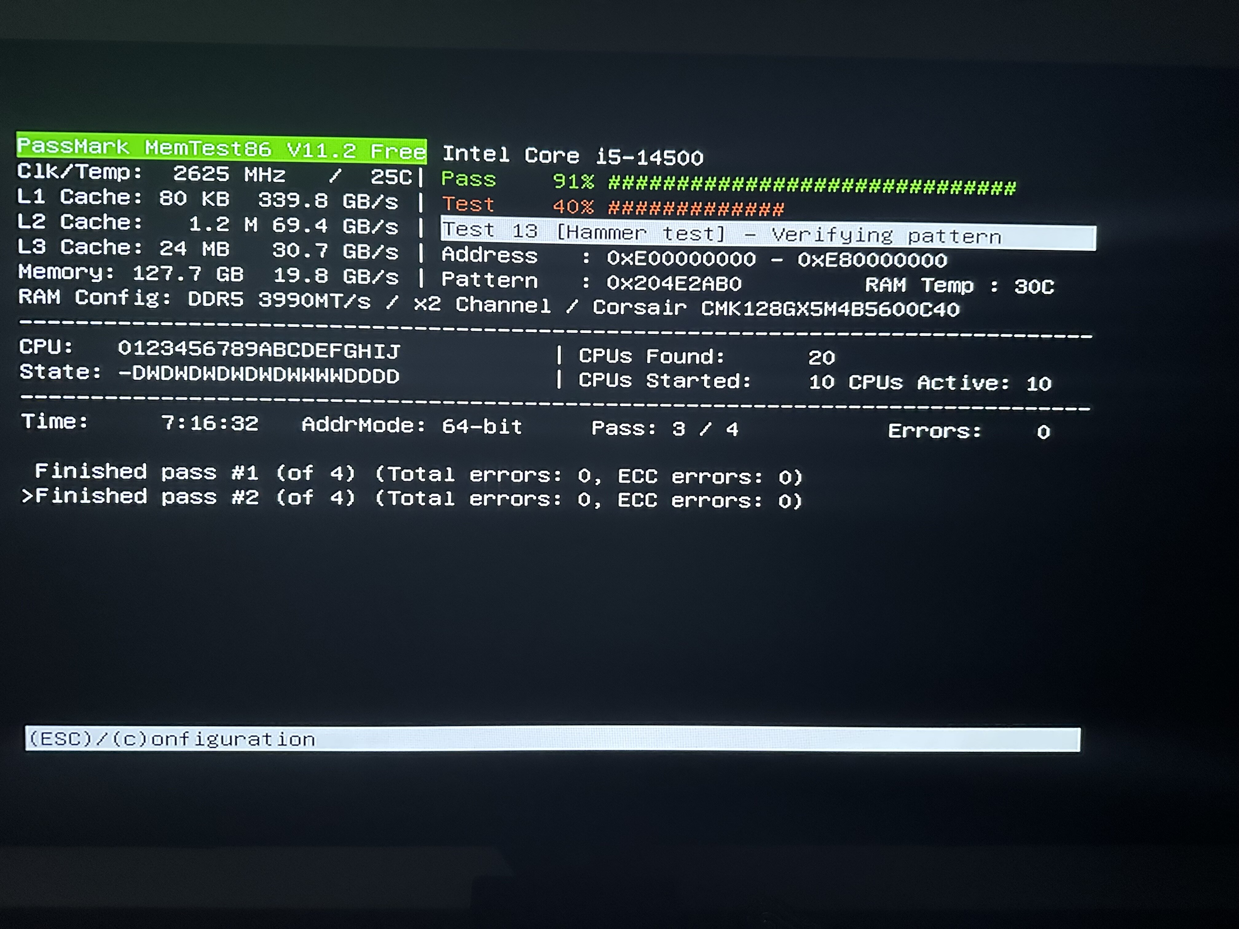

Downloaded and ran the newest Memtest v11.2 for over 7 hours with 0 errors. After almost finishing the 3rd pass I cancelled the test as I am sure I would have seen at least some errors by now if it was the RAM.

It's worth a try, also remember that memtest is only definitive if it finds errors, if you have multiple sticks try using the server with just one, if the same try with a different one, that will basically rule out bad RAM.
