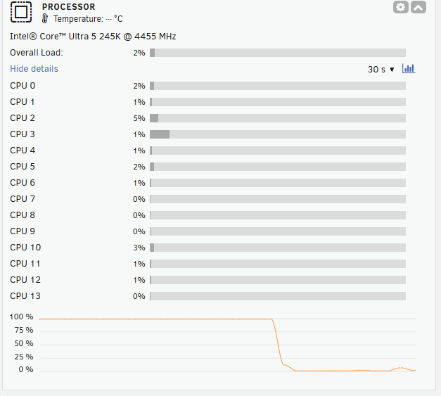

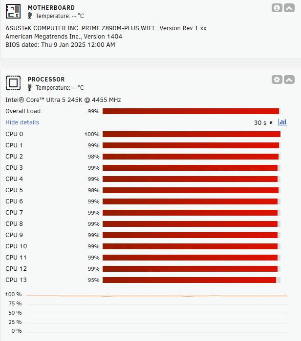

February 12, 20251 yr Author I recently upgraded my server with an ASUS prime z890m wifi plus motherboard & Intel Core 5 Ultra 245K, 64GB DDR5 RAM, but no gpu. (going to add that in the future) Is there anyway to utilise the igpu from the cpu in ollama? I ran the deepseek-r1:8b [~4.7GB] and the response took about a minute then it proceeded to write at about about 1-3 words per second for the duration of the response. Maxed out the cpu while it was thinking and responding.

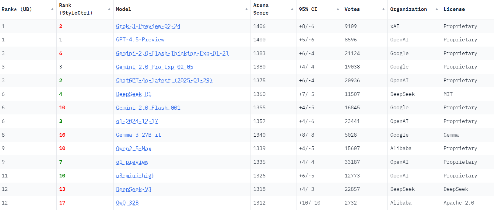

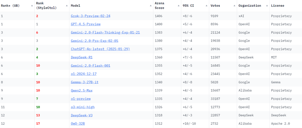

March 17, 20251 yr Author Chatbot Arena is an open platform for crowdsourced AI benchmarking, developed by researchers at UC Berkeley SkyLab and LMArena. With over 1,000,000 user votes, the platform ranks best LLM and AI chatbots using the Bradley-Terry model to generate live leaderboards. https://lmarena.ai/?leaderboard Edited March 17, 20251 yr by Maximo101

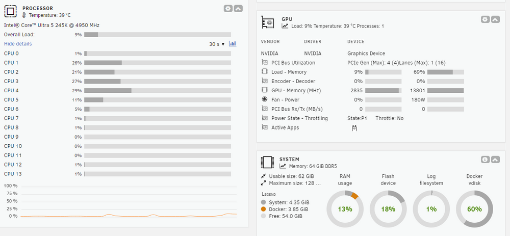

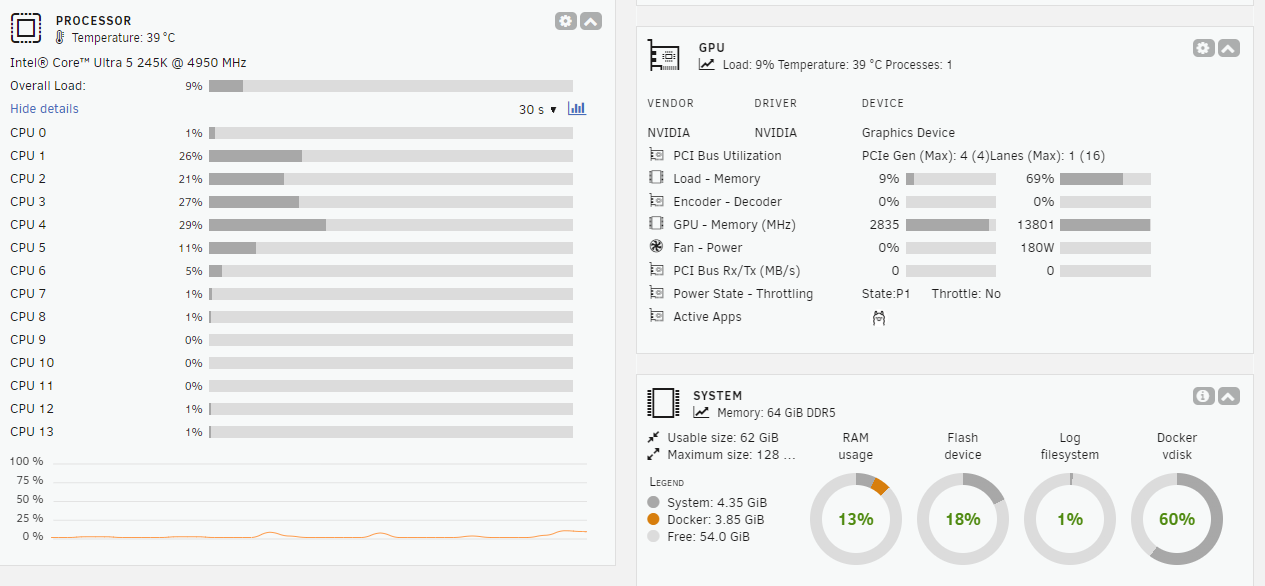

June 8, 20251 yr Author anyone else running local AI models?now that i have a gpu i have installed a few other models but not really tested too deep as i am using the free online ones for the harder tasks (gemini, claude, grok, chatgpt)I installed the Gemma3:12B-it-qat and this is the draw on the gpu when its responding, pretty quick respond speed (also running a parity check at the same time)

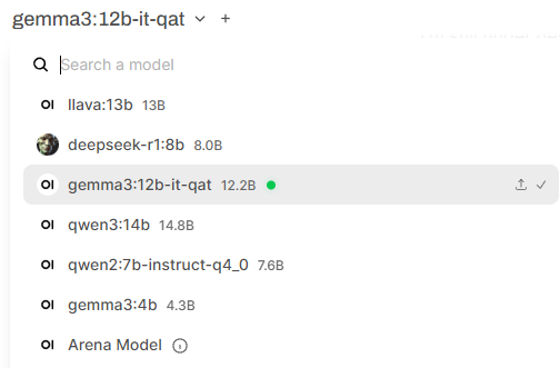

August 9, 20251 yr I'm running Ollama on a windows machine that has a better GPU than my unraid server. I'm happy with gemma3:4b-it-qat. I'm running Lobe-Chat and Open-webui on unraid, and frankly Lobe-Chat works better for me.
