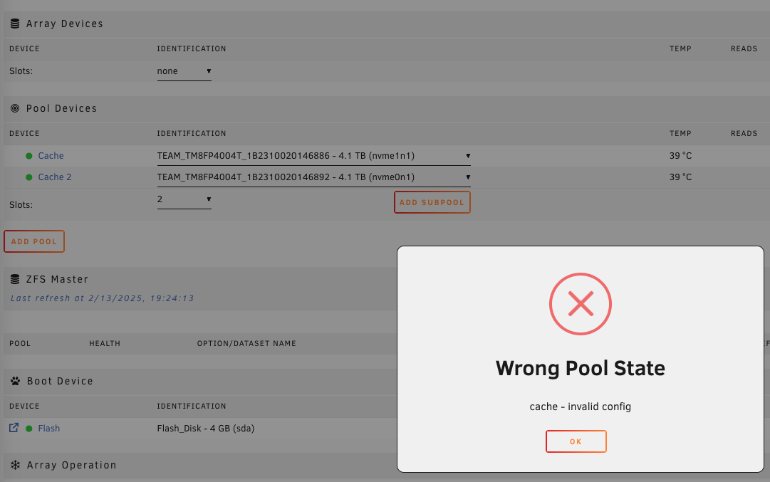

Then I decided to tweak the machine a bit and took down the pool and changed some parms. Nothing complicated (I think anyway). Set compression to on (Lz4 I guess), turned off spin down, turned on autotrim and set a monthly scrub schedule. But I also changed the host name from Tower to something more personal. I then rebooted and tried to mount the zfs pool with no luck. The GUI refuses to mount it while console command zpool insists that it's online and fully working without errors. In fact I can find no errors at all using console but the GUI still refuses to mount it. The message is 'invalid config' and this is where I am now. Also, both nginx and device restarted more than once.

OK - slots for the array (up top) have been set to 'none' all the time.
It looks like this: image.thumb.png.e35771ffdad49284b2af17929e3ed1da.png
Yes, sorry, got confused there, there's an issue with the pool config, to correct:
on main click on the first device for that pool and then "remove pool"
back on main, create a new pool with the same name and number of slots
assign the pool device(s), leave the filesystem set to auto
start the array to import the pool
Thank you, that worked out good! Pool is up and all data seems to be intact.

That wasn't caused by changing the trim and compression settings, the pool was configured for 3 devices, when it's only two, so something else caused that.

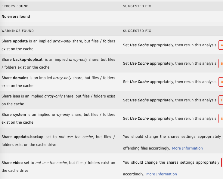

I just noticed that Fix Common Problems dont seem to like my zfs pool:
Not sure what settings for the cache pool I can change to make FCP happy again. Does Docker actually *require* an array?
Post new diags
Since your only assigned storage is cache, and all your user shares are on cache, you need to go to the settings for each of those shares and set them to
Primary:cache; Secondary:none

3 hours ago, Arneby said:
Yes, but every single one of them is already setup just like that.
Not according to the diagnostics!

I suggest making a dummy change on each share, and hitting Apply to force a new configuration file to be written for that share.   After doing that post new diagnostics so we can check everything now looks good.

1 hour ago, Arneby said:
However, since I dont have any other array or pool a dummy change is not possible.
You could always change something in the comments field!   The idea is to get the Apply button activated so that you can press it and get a new .cfg file generated for that share.
I think that what you have encountered is probably a bug and a side-effect of having nothing in the array and only one pool.
BTW:  In a case such as yours I would not have called the pool 'cache' as that is not what you are using it for.  I suspect you just accepted 'cache' as the default name for the first pool you create?
OK - so I added to or changed the comments for and hit apply for every share and that seemed to do the trick.
