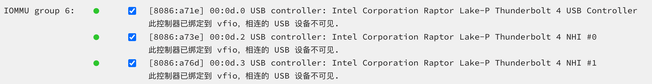

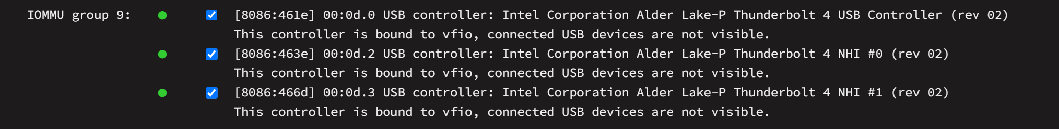

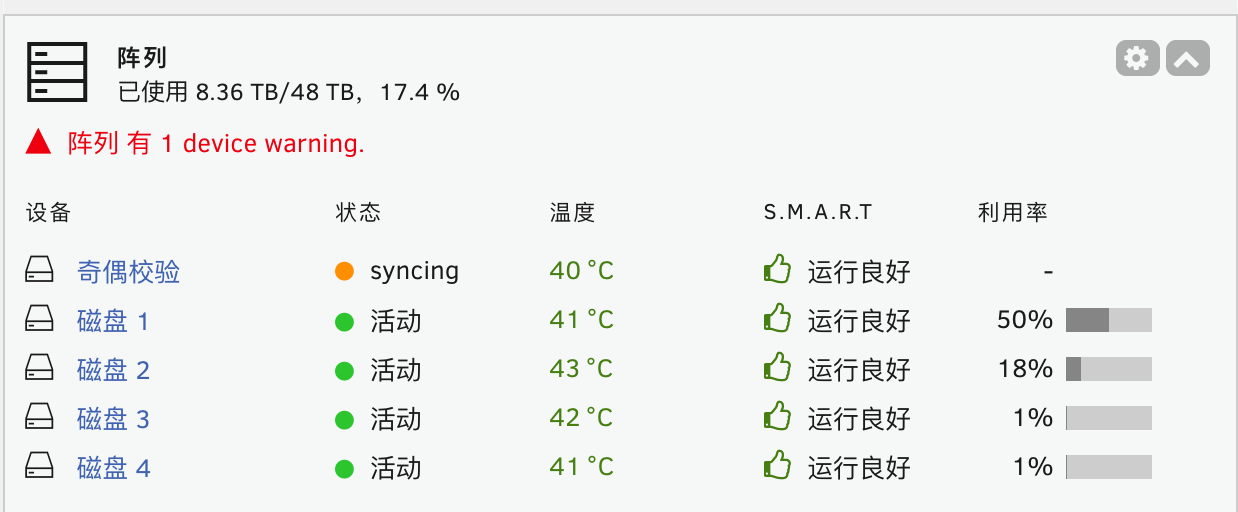

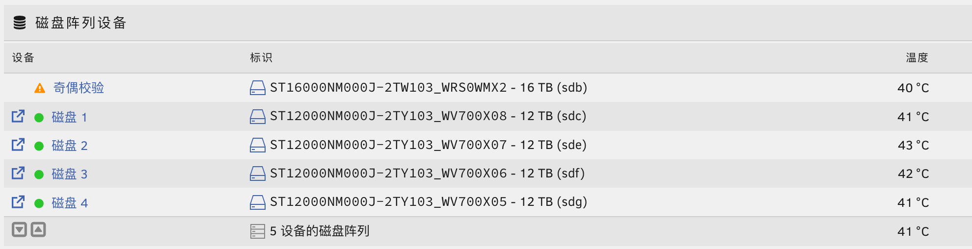

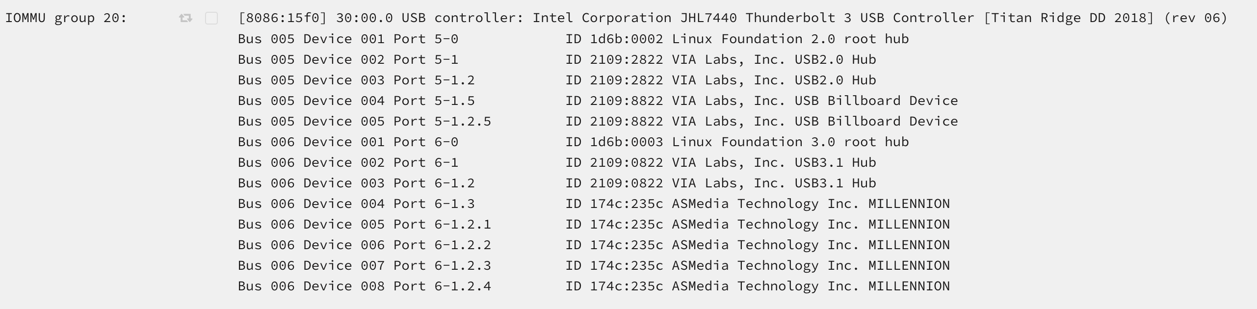

May 27, 20251 yr 在 7.1.2 版本中,将USB ThunderBolt 设备直通后,奇迹发生了,可以看到雷电磁盘柜了,也可以正常使用阵列。In version 7.1.2, after passing the USB ThunderBolt device, a miracle happened. The Thunderbolt disk enclosures can be seen and the array can be used normally.将这个设备直通,绑定 VFIO 设备:Pass this device through and bind the VFIO device:这个JHL7440 控制器不要直通,如果也选上了,反而看不到设备!This JHL7440 controller should not be passed through directly. If it is selected, the device will not be visible!重启后就可以看到设备了!smart 和温度信息正常!After restarting, you can see the device! Smart and temperature information are normal!不得不说,这个坑够深的,希望能在后续版本得到正式解决。 在 6.12.15 版本是没有这个问题的,不需要直通 雷电接口就可以直连磁盘柜了。我的设备:主机:MinisForum MS-01雷电磁盘柜:MILLENNION 8858T3I hope it can be officially solved in the subsequent versions. There is no such problem in version 6.12.15. You can directly connect the enclosures without the direct pass-through Thunderbolt .My equipment:Host: MinisForum MS-01Thunderbolt disk enclosures: MILLENNION 8858T3

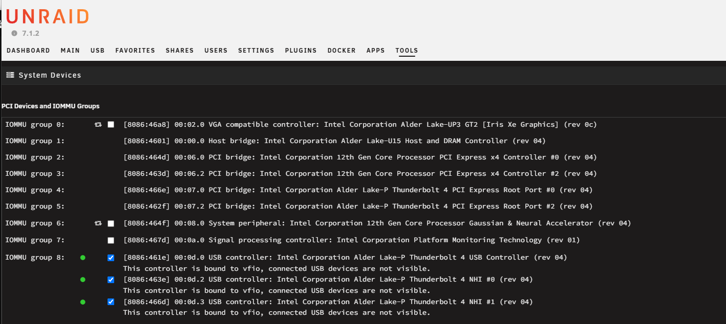

May 30, 20251 yr OK, I think I found a solution. Went to Tools -> System Devices and checked the Thunderbolt controller. Then selected "Bind Devices to VFIO" At Boot" Rebooted and now Drives are showing up fine.
June 3, 20251 yr I just wanted to add to this thread that the above suggestion also fixed my issues with my OWC Thunderbay 8 enclosure not being visible under Unraid 7. Selecting the following devices to bind to VFIO at boot solved the issues. The drives in the enclosure showed up right after a reboot. This is on my Intel Serpent Canyon NUC
June 8, 20251 yr Dropping a line here added the same 3 to vfio and got my nvme tb4 enclosure to work. Ty!
