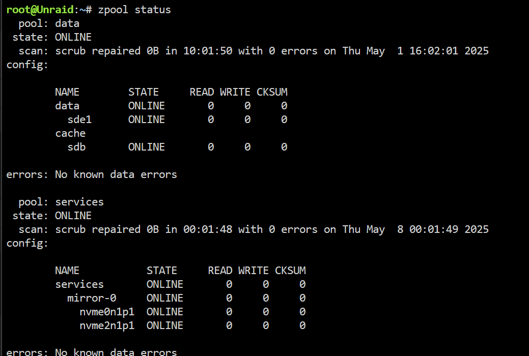

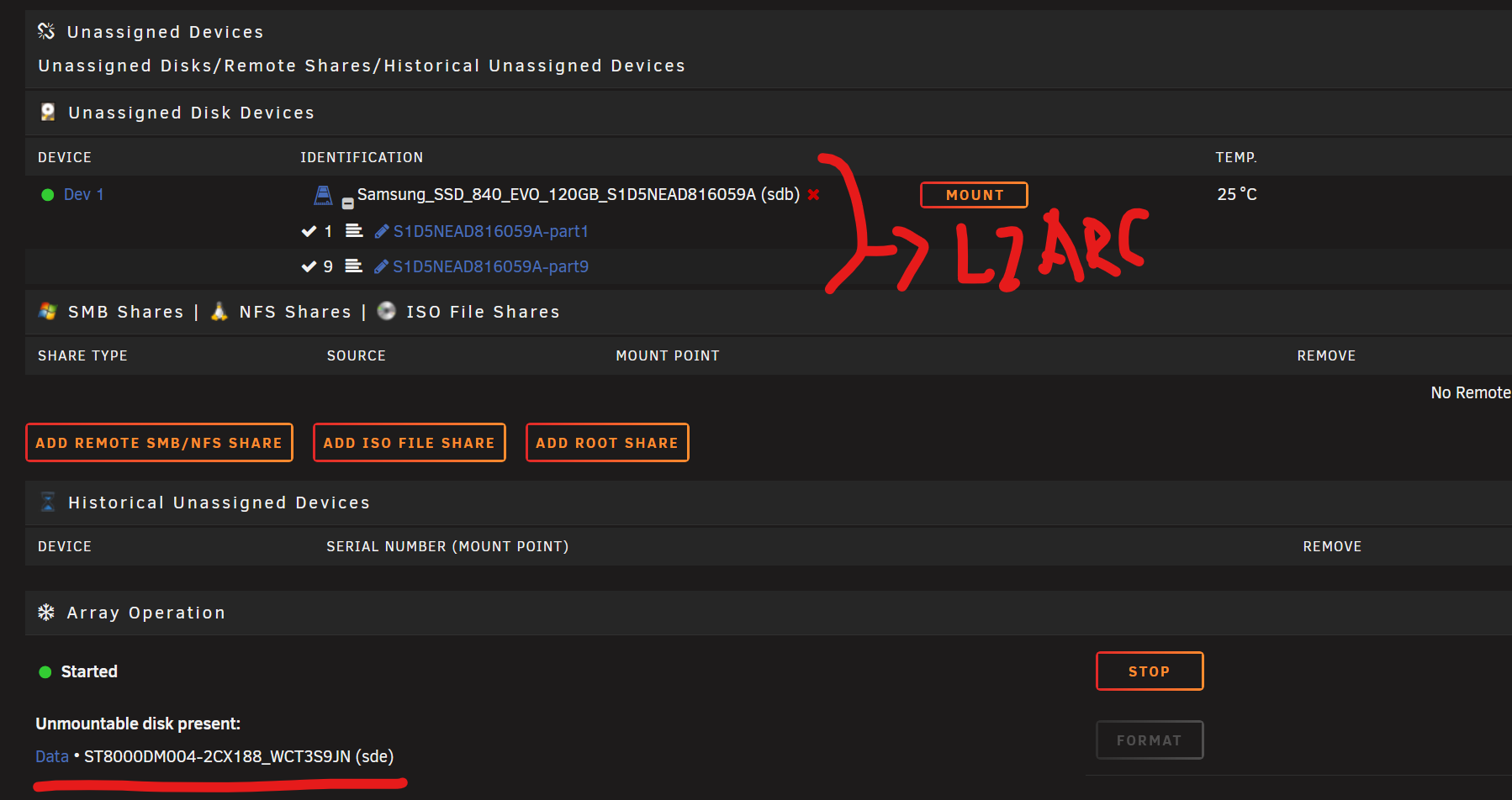

every time a reboot I have to do "zpool import data"
services pool works fine.
Diagnostics attached
It works fine after zpool import data

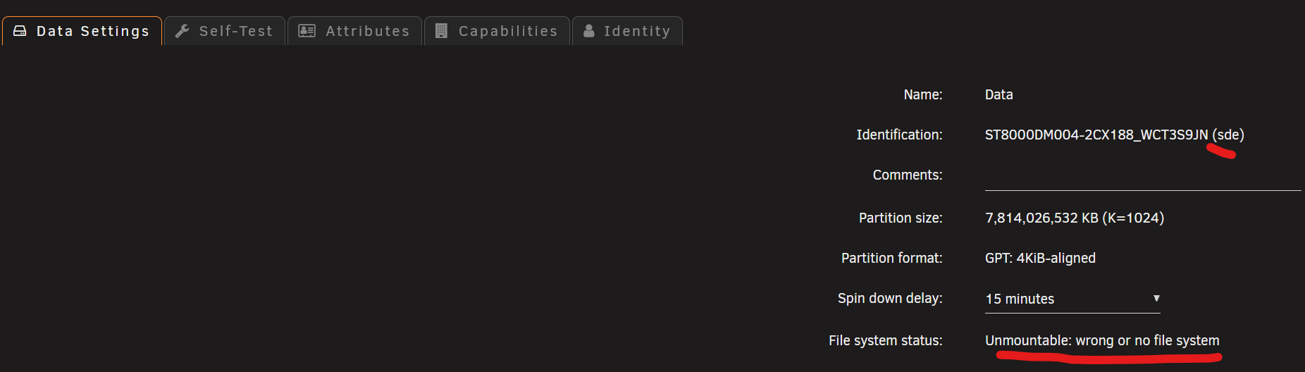

But UI doesn't recognize it properly and is not able to import it properly after reboot.
unraid-diagnostics-20250510-1416.zip
Edited by L0rdRaiden
Like mentioned in this thread, all devices form a pool must be assigned to that pool, including any subpool, make sure the pool is exported with
zpool export data
Then click the pool device and then "remove pool"
back on main, create a new pool with the same name and 2 slots
assign both pool device to the pool, don't create subpools, leave the filesystem set to auto
start the array to import the pool
