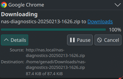

You must have attached the file before download was complete, it has .crdownload extension.
Try again.
hmm yes it seems like it is not completing the download every time I tryScreenshot_20250213_162658.png.9f0955109eb03739783369199ac77a7b.png
I was able to open it.
