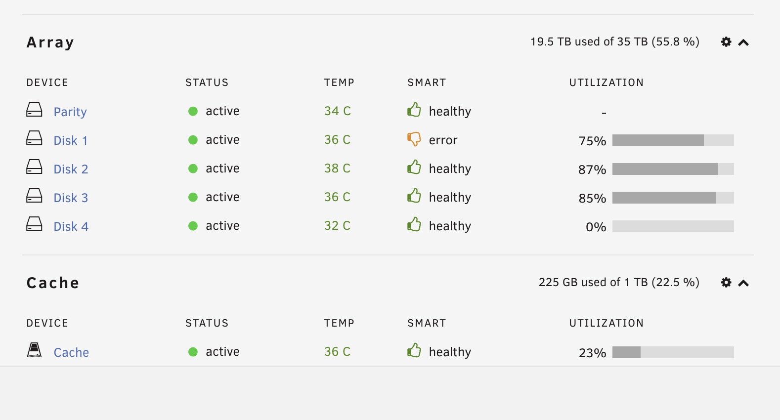

now, i'm super into unraid again and have a couple questions. one of my drives has an error?
i ran smart test and it says its fine? this drive is only 3TB - should i just replace it?

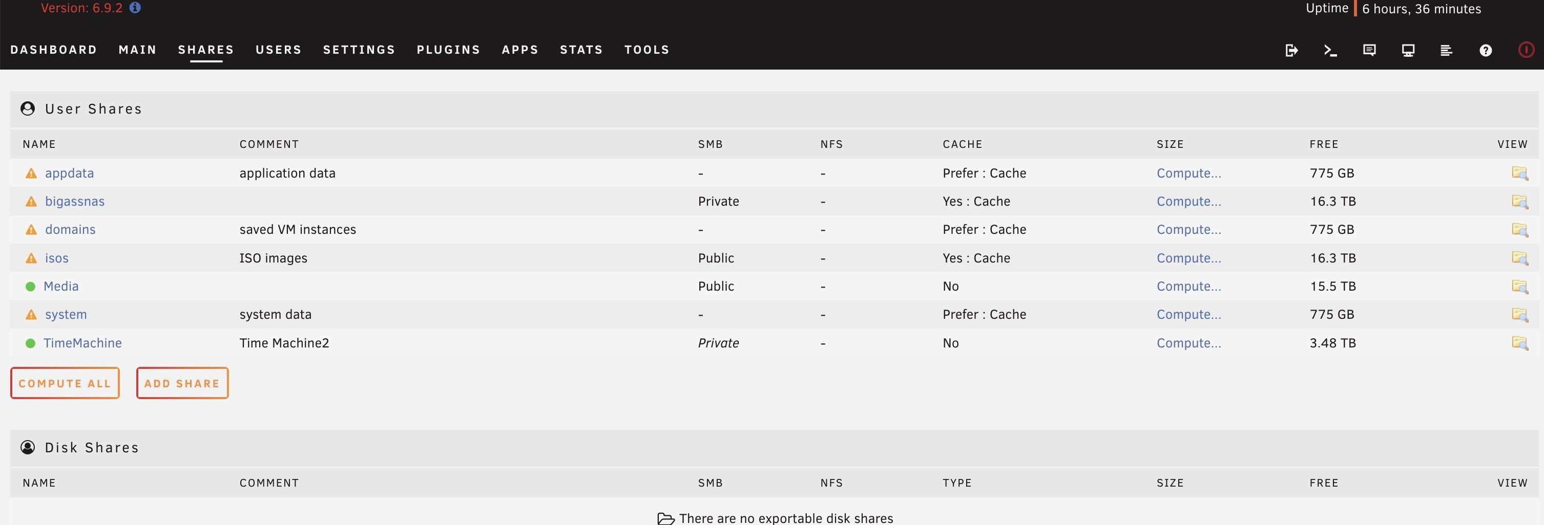

why do my shares say unprotected?

Any share with files not in the parity array, and not on a redundant pool, are not protected. That is normal, and you really want appdata, domains, system shares off the array anyway. Can't tell some things about your shares from your diagnostics since you are running such an old version of Unraid.
Adding another 1TB drive to your cache pool to make it btrfs raid1 would make it redundant and those warnings would go away.
Disk1 has 1 pending sector. You could replace it, or maybe rebuild it to see if that pending sector would be reallocated. You can click on that SMART warning on the Dashboard to acknowledge and it will warn again if it increases. But pending sectors is one that I prefer to eliminate one way or another.

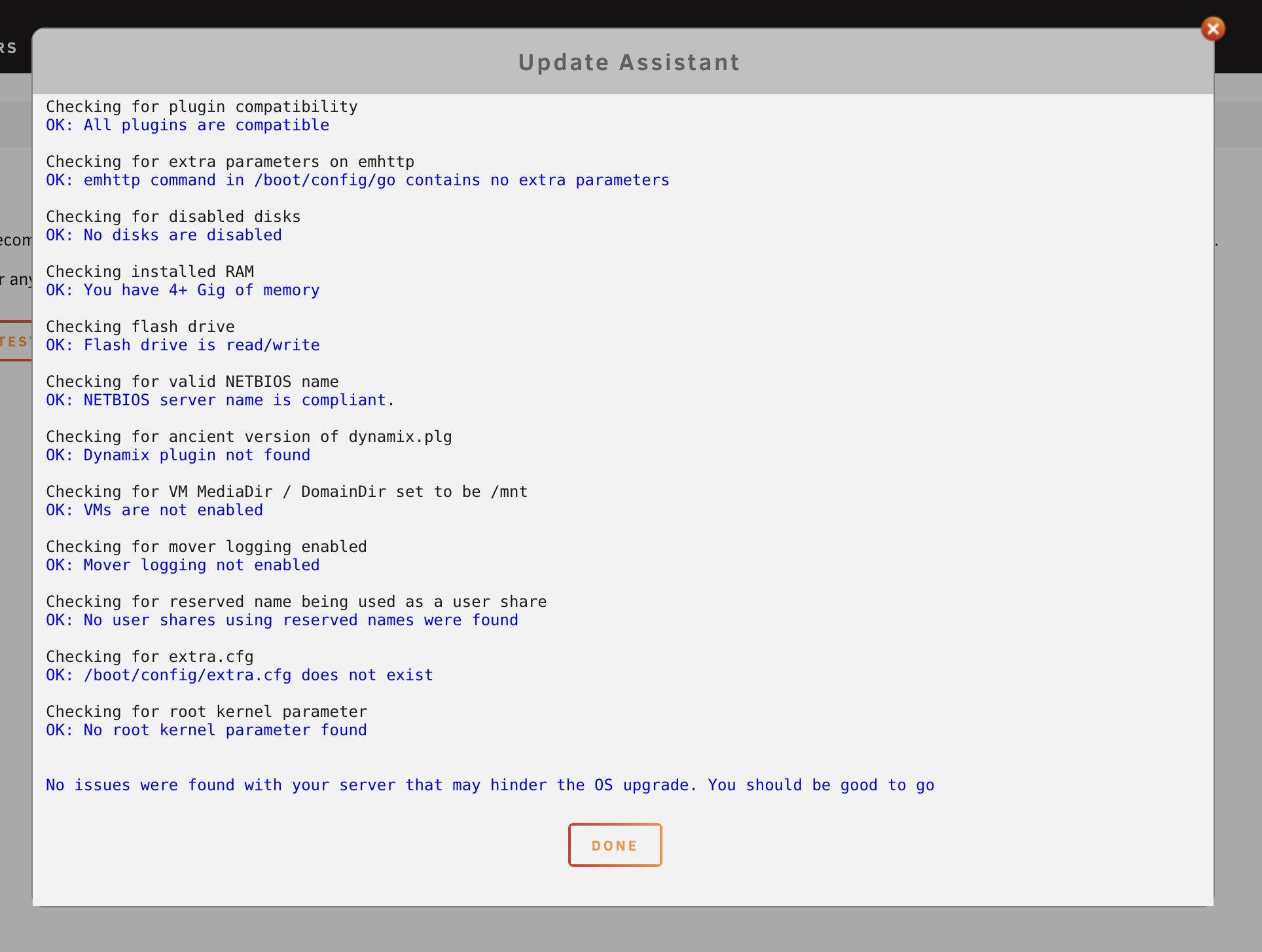

Go to Tools - Update Assistant (if it exists on that old version) to see recommendations before upgrading.
i haven't turned it on since 2022. i'm scared to update to 7? i guess i have to?
Also read the release notes.
i updated or removed anything that couldn't be updatedScreenshot2025-02-14at5_54_23PM.thumb.jpg.e6574259be0d70e52882bb96c308c62b.jpg
i think it is. took a while to start the array but all the data appears to be there.
