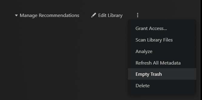

in plex empty the trash for all of your libaries

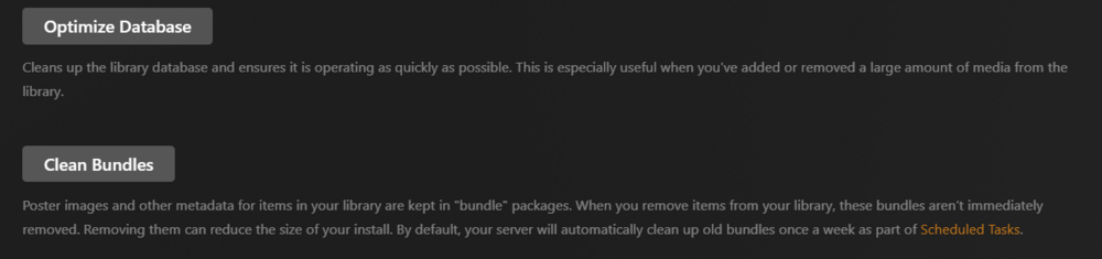

Under trouble shoothing run the optimize database and clean bundles
then go back to the libraries and rescan for media...

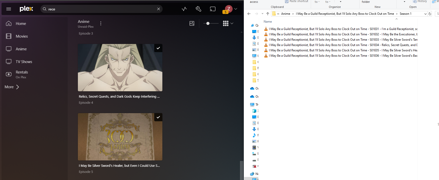

looking a bit closer and it looks like my TV and Animie sections are updating as well. see below for example
Fixed it. TY for the help it turns out the Plex DB was corrupted
