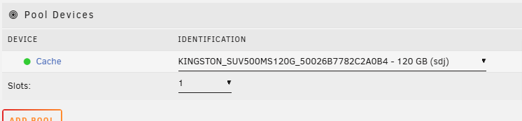

Edit: I've stopped the array, changed pool to one drive, now it's started without any errors. All good :) Thank you very much for your help.
