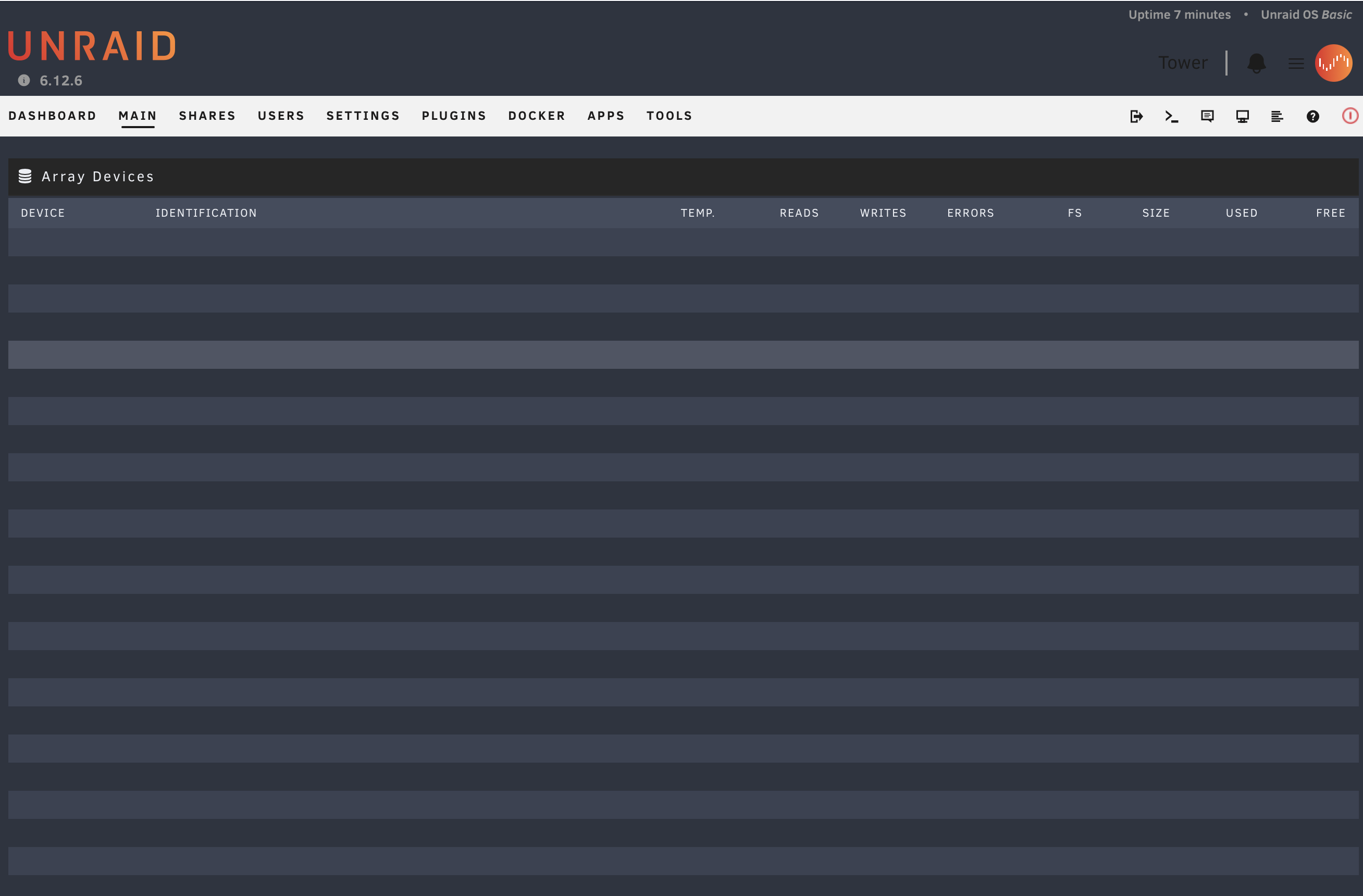

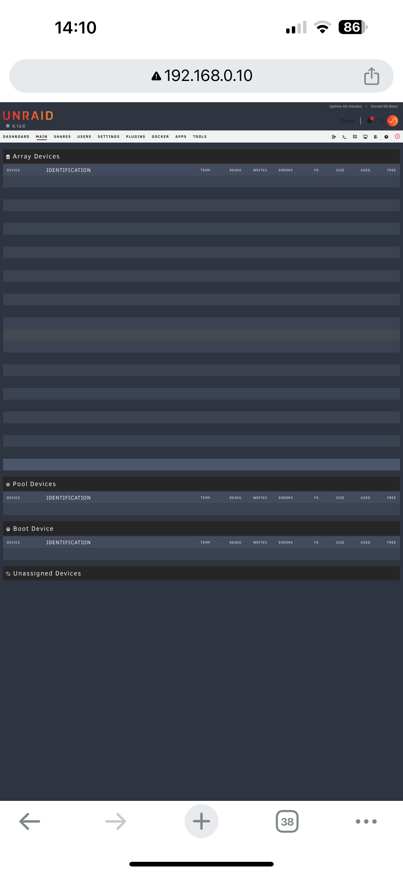

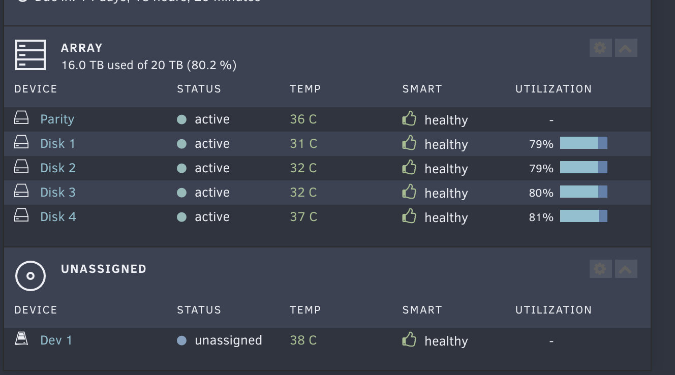

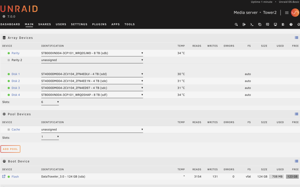

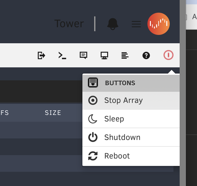

So I had a power cut, after turning my server back on, Array Devices is empty. Inititially I saw a pop up saying `flash device is corrupted`. So I created a new flash device, copying over my /config, but nothing is recognised. Reverting back to the original flash device, I noticed I can start the array by using the buttons in the top right. My array is online, i can see my shares. But I think my cache is not recognised. I can see all my files in my shares via SMBD. But no docker containers are running, which I think was stored on my ssd. I have no idea lol. Thanks for help in advance :)
Screenshot2025-02-14at13_34_27.thumb.png.cfebe369df6fe13e46e5d4a69e46cdbe.pngScreenshot2025-02-14at13_39_10.thumb.png.75c991c64dc10ec7242be781f275d917.pngScreenshot2025-02-14at13_34_38.png.6c6c8521740497e4b42752ddee9134d2.png

Try using a different browser, or even a different device, like a tablet or phone.
Same thing on chrome iphone. Original was safari on macbook.

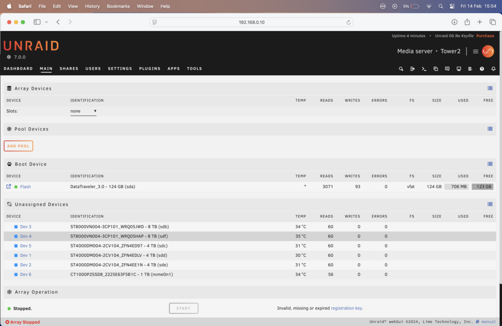

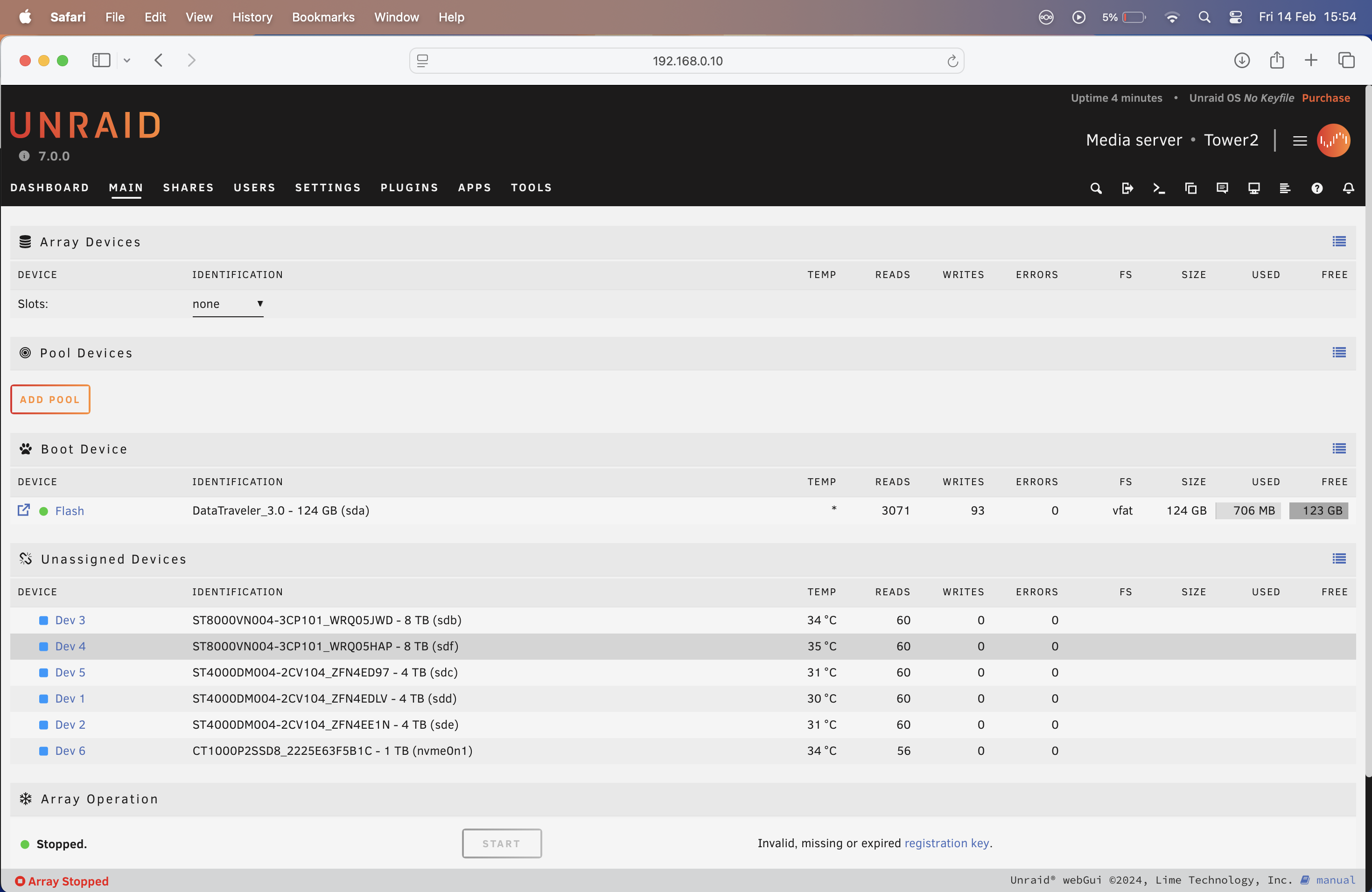

Try recreating the flash drive, first backup the current one, then recreate it using the USB tool, confirm the flash drive boots with the stock install and that you can see the devices, and if yes, restore only the /config folder from the backup overwriting any existing files, if the issue returns after that, there's an issue with the config.
Screenshot2025-02-14at15_54_17.thumb.png.e254e4bb9deb883ff37f1ff482b47e0f.pngScreenshot2025-02-14at16_06_28.thumb.png.1858af363627f75c6135ee2c92389d54.png

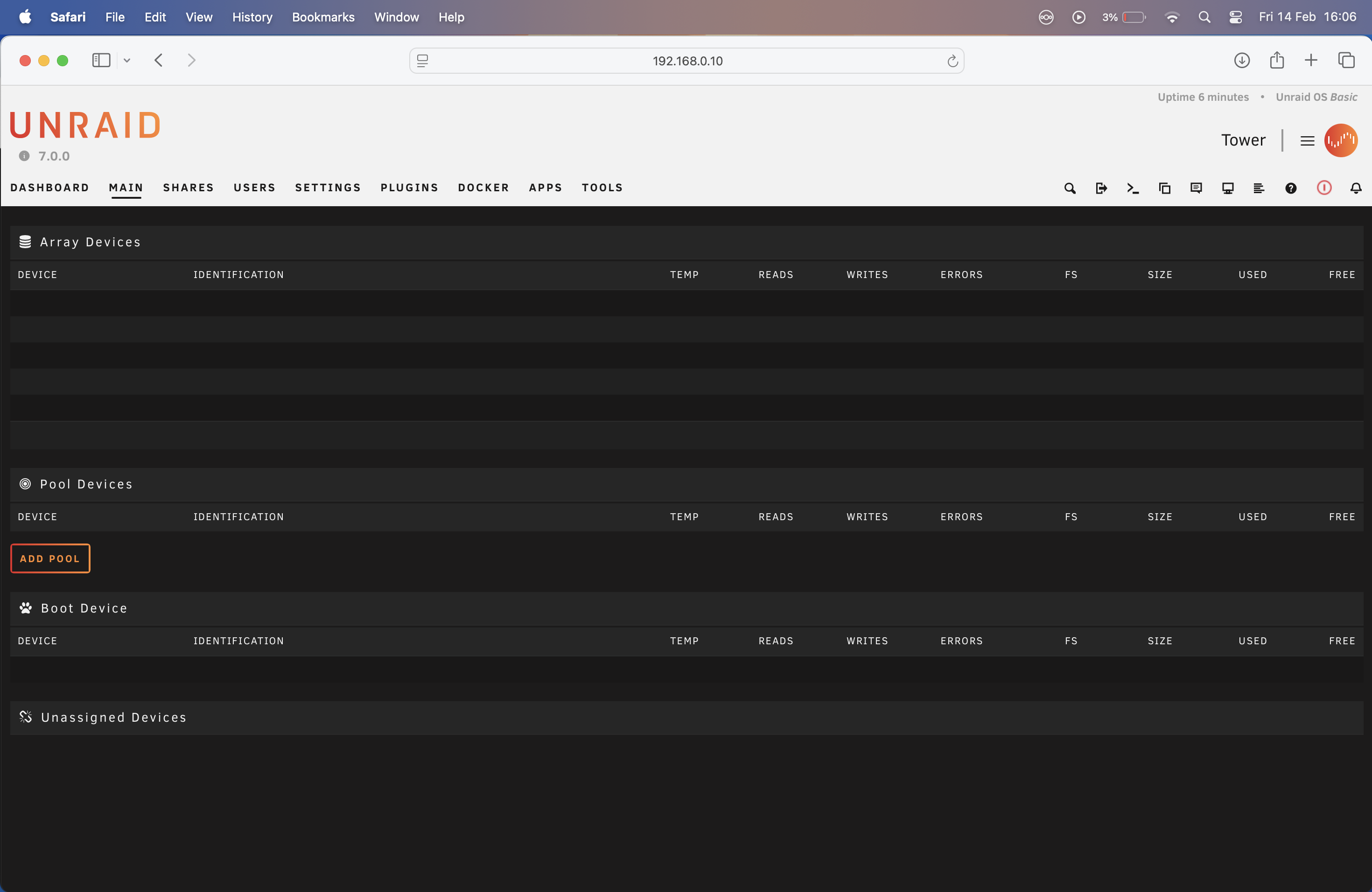

So I backup flash drive, recreated it using the USB tool. All my hardrives and nvme is recognised. When I copy back the /config (overwriting). I get the second image. 😢. So you are right, my config is messed up. I don't have a backup (lesson learnt ...).

You can just restore the bare minimum, like the key, super.dat and the pools folder for the assignments, also copy the docker user templates folder (\config\plugins\dockerMan\templates-user), if all works you can then reconfigure the server or try restoring a few config files at a time from the backup to see if you can find the culprit.
Nice, ok making progress. Although I see my cache was unassigned by default? But when i add the nvme it all works. I have added the folling things bac:

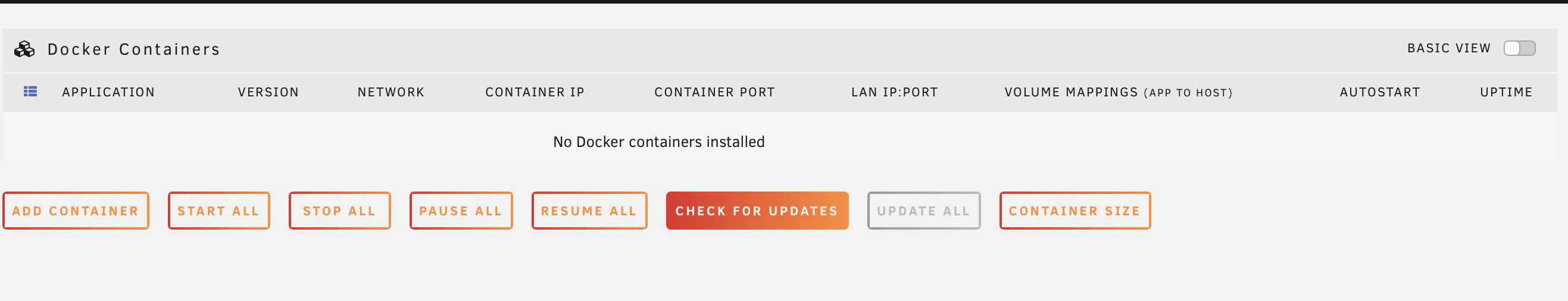

However all my docker containers are gone? I have started docker. All my app-data looks good in my share. Is there a certain file I need to add back? Thanks for the amazing help so far :)
Screenshot2025-02-14at17_47_51.thumb.png.c6a55c31070ed480c482c4cd07dcf516.pngScreenshot2025-02-14at18_49_09.thumb.png.a1734f09b6790002cb16615652f89b6c.png
You can just reassign the pool device, and if you have the old appdata and the user templates folder, you can easily recreate the docker image, and that should bring all the containers back:

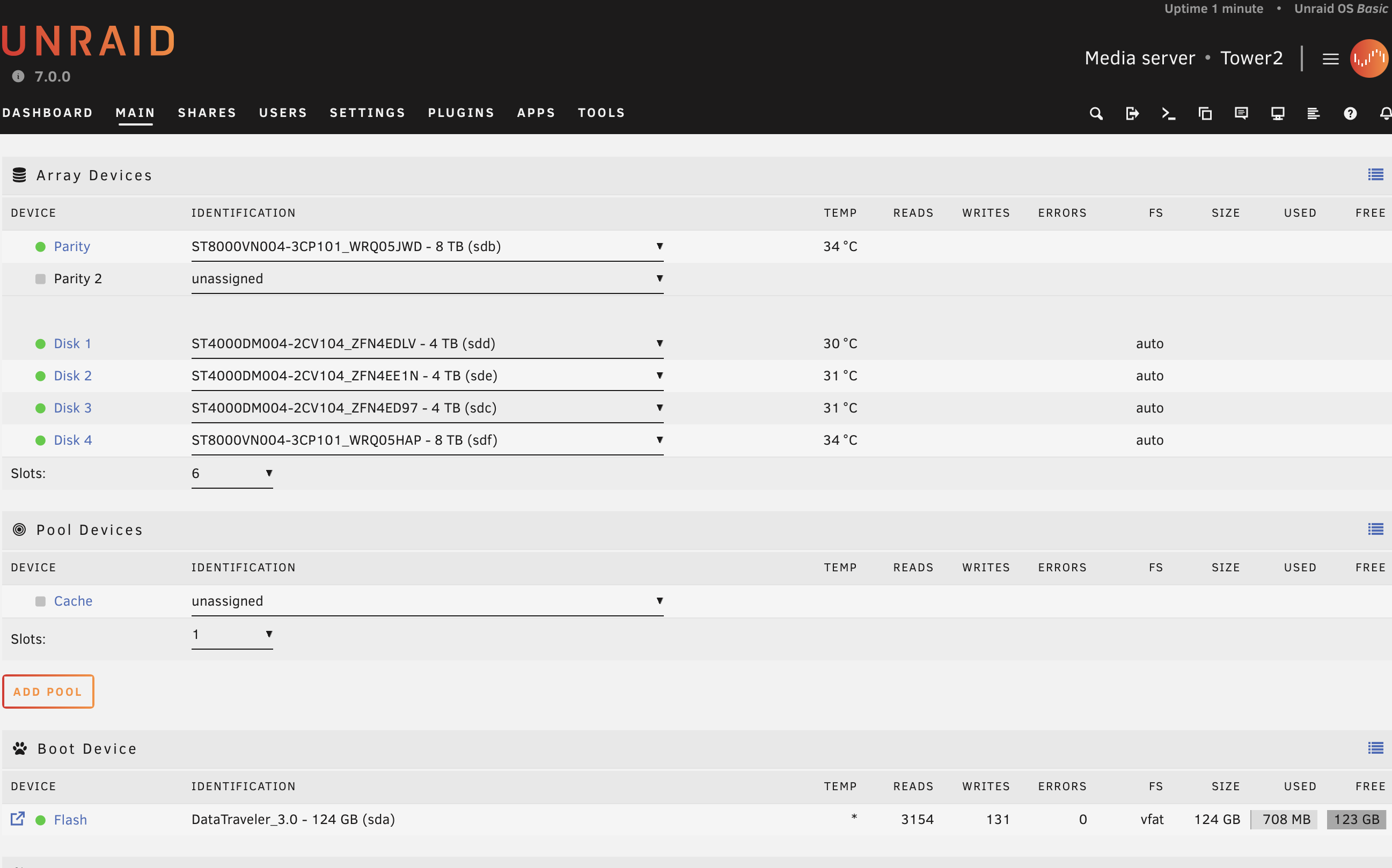

Amazing. Everything working. Thank you so much for the help. :)
