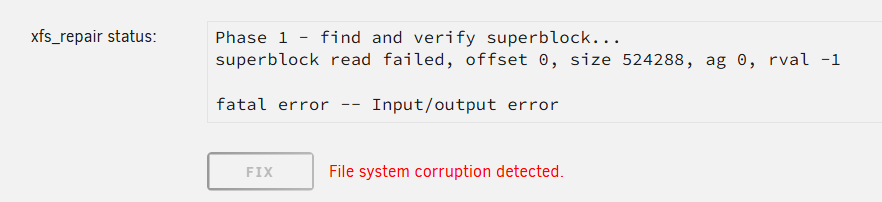

Thanks for the reply. Yes, I meant to say that I tried the "fix" option in the Check Filesystem status and it didn't work. This is the error message:
Phase 1 - find and verify superblock... superblock read failed, offset 0, size 524288, ag 0, rval -1 fatal error -- Input/output error
I also tried it in terminal with all the other -L, -V, -N options

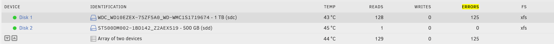

Its also showing some Errors here:
Actually looking further, the extended SMART test is showing read failure.
dactower-smart-20250215-1244.zip
# 2  Extended offline    Completed: read failure       90%     35024         64312740
That disk should be replaced
