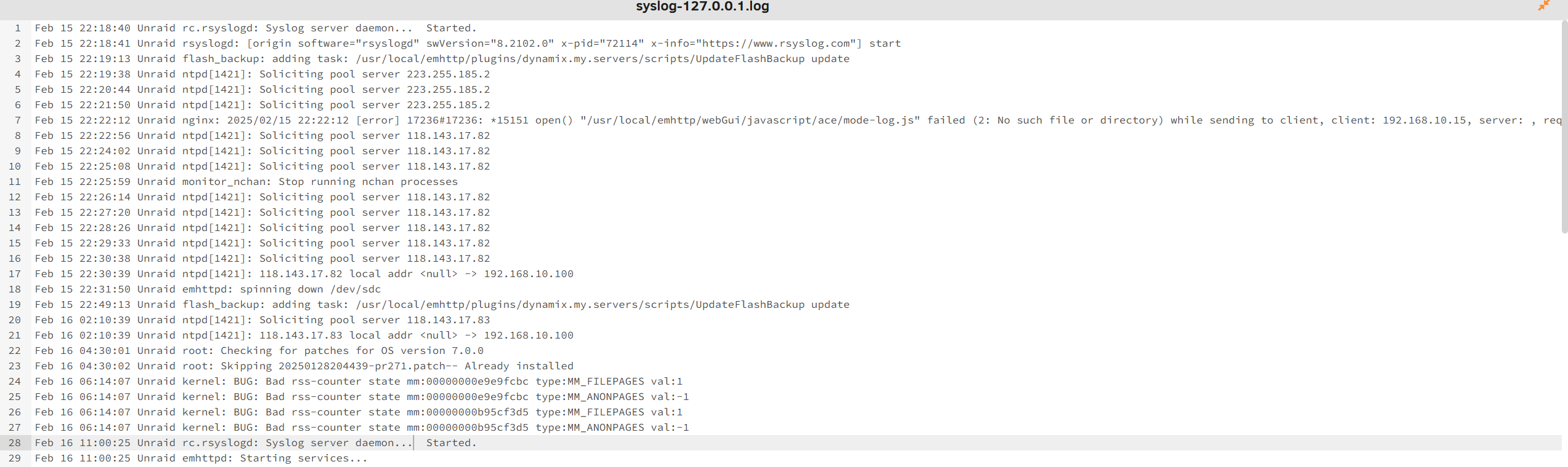

升级7.0之后,出现CPU满载,webui失联无反应,unraid地址能ping通,其他docker,虚拟机均无反应,日志如下
升级7.0之后,出现CPU满载,webui失联无反应,unraid地址能ping通,其他docker,虚拟机均无反应,之前6.12版本一直没问题。
内存测试也PASS了
日志如下,,这个kernel BUG不知道是啥,希望大佬指点一下
Feb 16 04:30:01 Unraid root: Checking for patches for OS version 7.0.0
Feb 16 04:30:02 Unraid root: Skipping 20250128204439-pr271.patch-- Already installed
Feb 16 06:14:07 Unraid kernel: BUG: Bad rss-counter state mm:00000000e9e9fcbc type:MM_FILEPAGES val:1
Feb 16 06:14:07 Unraid kernel: BUG: Bad rss-counter state mm:00000000e9e9fcbc type:MM_ANONPAGES val:-1
Feb 16 06:14:07 Unraid kernel: BUG: Bad rss-counter state mm:00000000b95cf3d5 type:MM_FILEPAGES val:1
Feb 16 06:14:07 Unraid kernel: BUG: Bad rss-counter state mm:00000000b95cf3d5 type:MM_ANONPAGES val:-1
Feb 16 11:00:25 Unraid rc.rsyslogd: Syslog server daemon...  Started.
