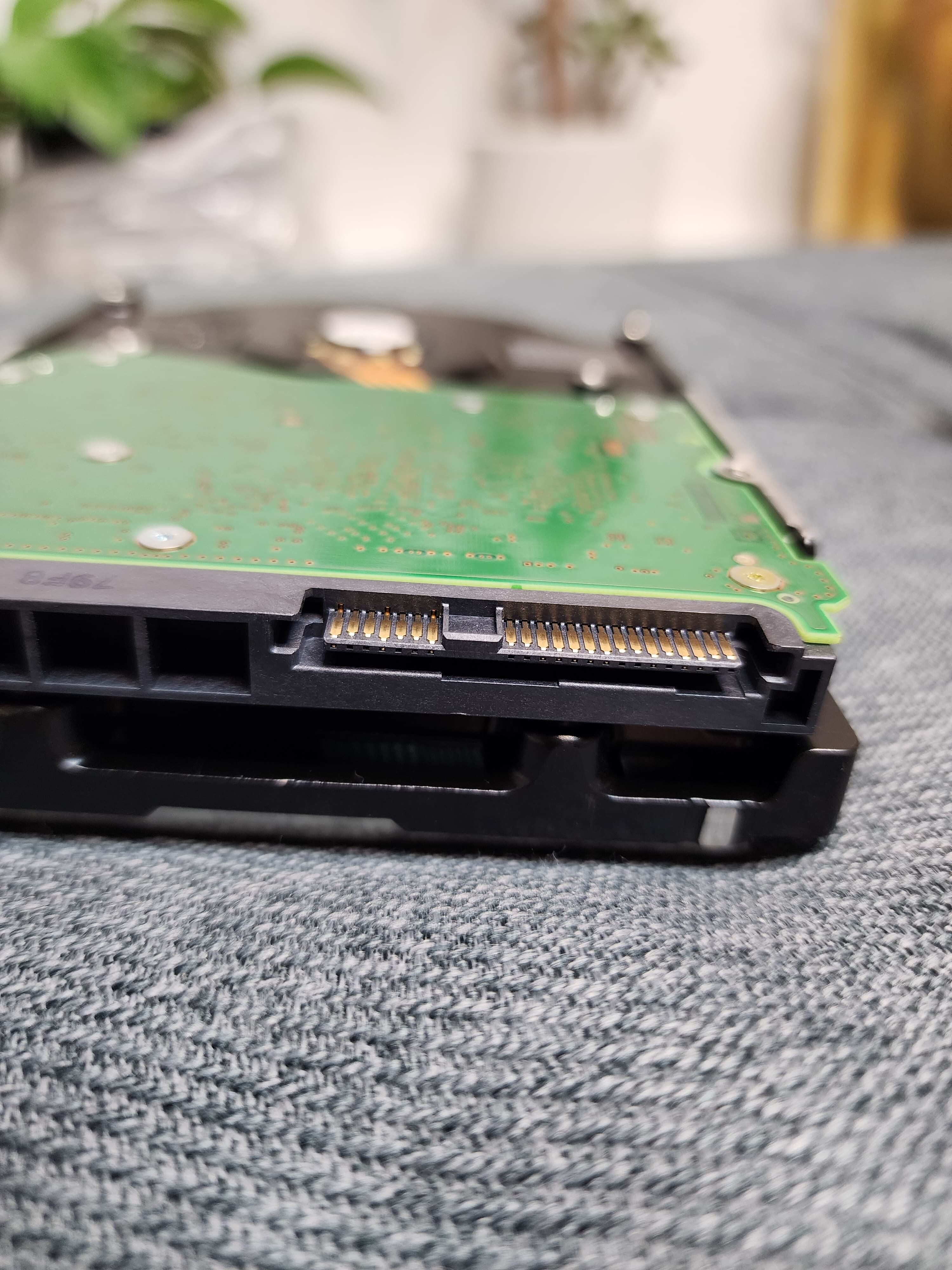

Thanks, I will get a LSI HBA as suggested but I am still a little confused as to how these drives get power. Looking at the cables provided, it doesn't look like they will fit my drives. I will not be using a backplane. Please see picture of my drive.
You can then plug your standard SATA power connector on the cable shown by Jorge.
It seems obvious, but we had a long debug session some time ago with a user that didn't plug the power connectors. :D
They probably thought the HBA card was powering the drives.

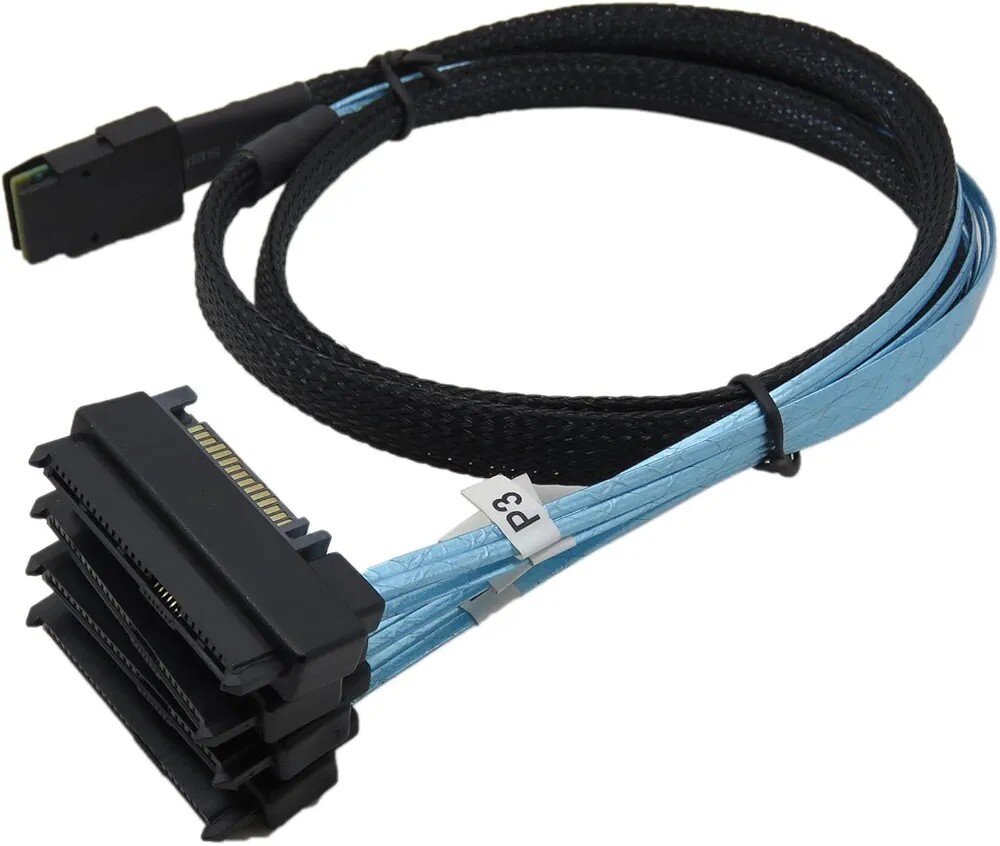

Is this cable called "Mini 4 SAS 36-Pin SFF-8087 To 4 SAS 29-Pin SFF-8482 Cable Connectors with 15 Pin SATA Power"?
Yes, that is for a SAS2 LSI, for SAS3 it would be an SFF-8643 to SAS
Thanks, I am thinking of getting the 9207-8i, is that SAS2?
