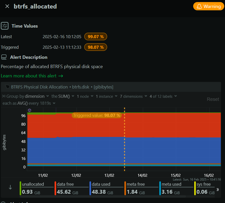

Since a week or so back I've had this error reported in Netdata:
BTRFS allocated space utilization.
Since the only drives I have that uses BTRFS is the cache-drives (my main storage NVME, my media cache disk and my NVR cache disk) I've isolated these three. I don't, however, know how to decipher which of these three that it concerns. I also dont know what the problem is and how to ammend it?
I am sorry if this question is asked in the wrong part of this forum - fairly new here but eager to learn.
Cheers!
Kalle

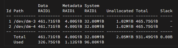

As far as I know it's perfectly normal, as btrfs does copy on writes when something is changed a new block is allocated to store it, the old location is freed internally but not deallocated. So after a while it's normal for the entire medium to be allocated and it'll remain so unless you run a balance which forces it to reorganize/consolidate everything at which point it'll deallocate what it doesn't need.
Here's my cache, 100% allocated too, has been for years probably.
Netdata makes a warning for it but it's silent by default and is just not meaningful.
