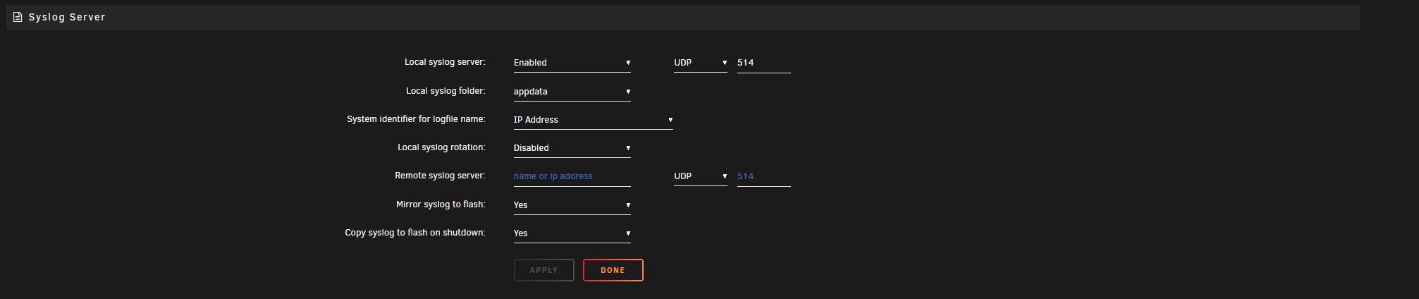

I did not know this. But now I looked at the destination folder and there was nothing in it. Is there something wrong with my settings? I changed the location to appdata. It was on the array before. Alos i changed the mirror syslog to flash to Yes. Anyway I hope that it will work next time. How can i be sure that it logs now?
You should find a file in the ‘logs’ folder on the flash drive since you have the ‘Mirror to Flash’ options set to yes.   If you want a file instead to be written to the ‘appdata’ folder that you specified as Local Syslog Server setting then you need to put the IP address of your Server into the Remote Syslog Server field.
This should be explained in the diagnostics link, but if you find that unclear then I suggest you mention in what way so that Limetech can use that is input to improving the documentation.

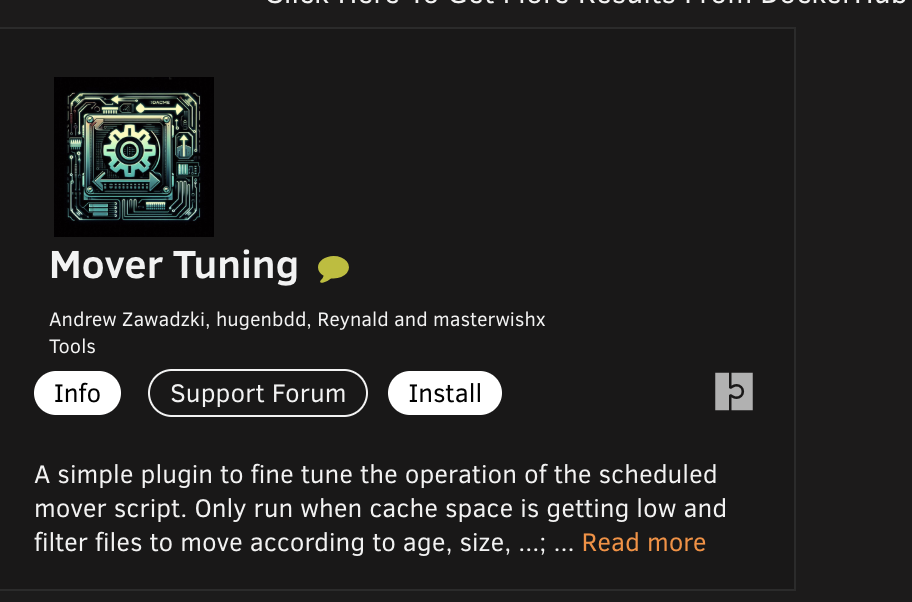

So I found some youtube comments where people removed mover tuning plugin after upgrading to 7.0 because it brakes it. I think my problem is related to that. Does anyone have more info about that?
The only mover tuning plugin which should be used on 7.0 is from masterwishx.  Fix Common Problems (if installed) would have notified everyone that the others are all deprecated
I have fix common problems installed but it did not show any faults with mover tuning plugin. The last update for my mover tuning plugin was somewhere in 2024. I will try this one now.
