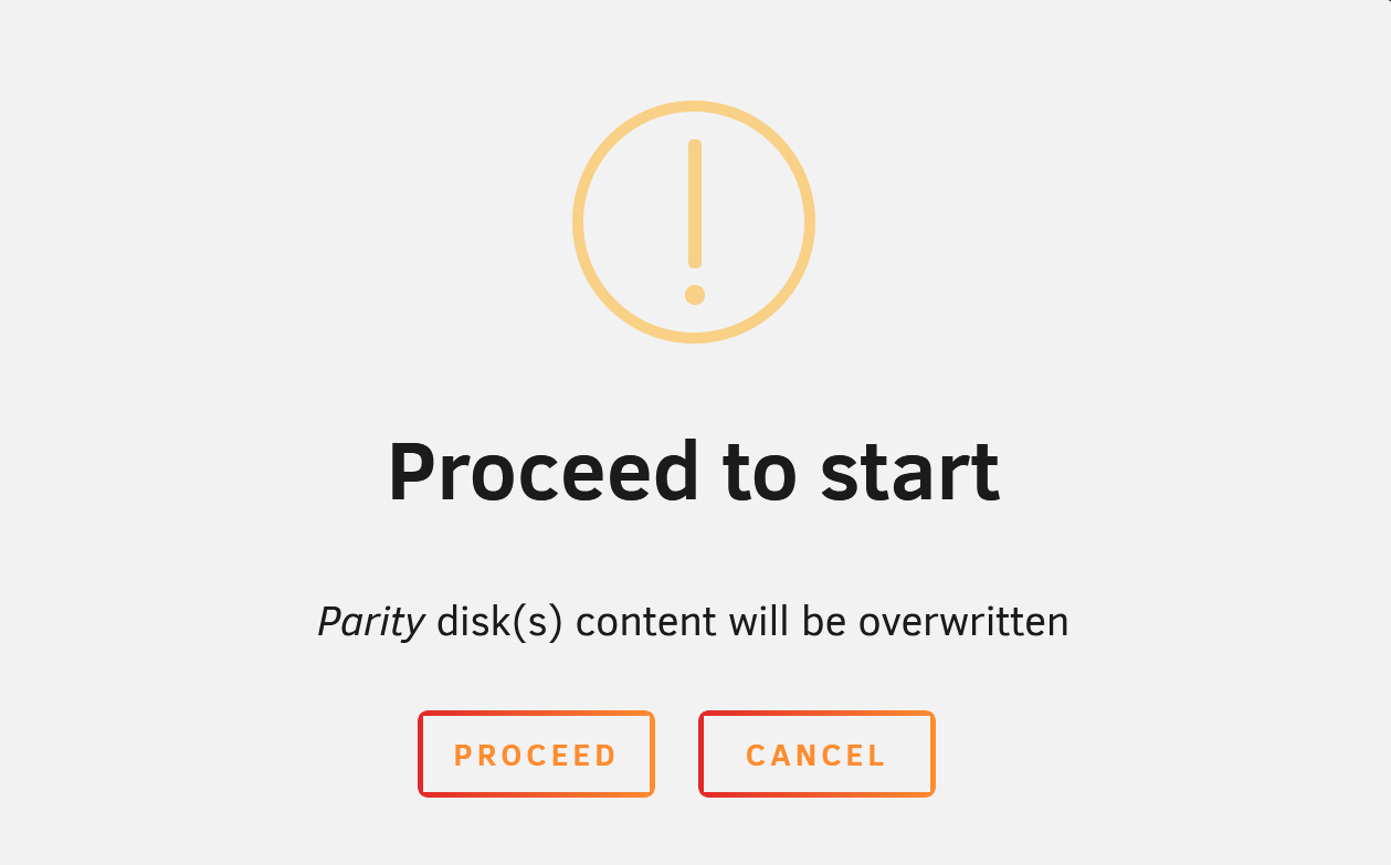

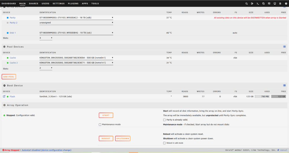

I have added two brand new disks to my "new" Array. When i click on Start, nothing seems to happen.
I have tried multiple times, and restarted multiple times, and same issue. I have tried my best to search the docs and google for some help.

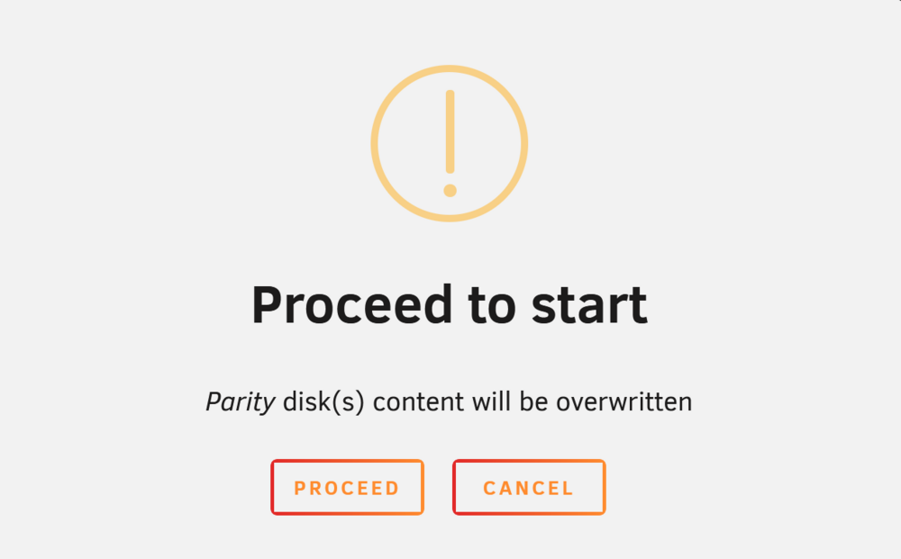

I get this prompt, and press proceed, and then nothing really happens.

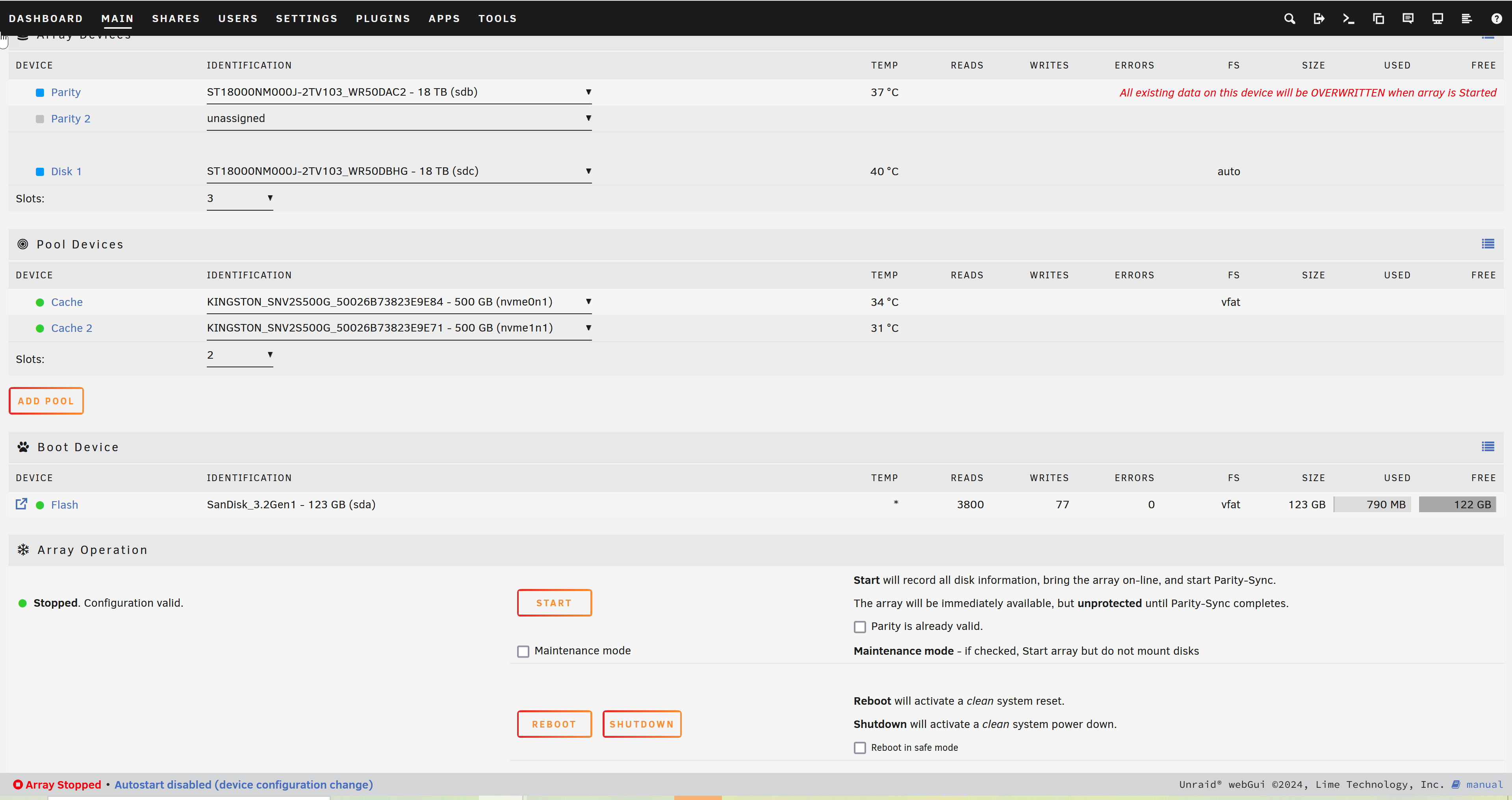

There's no error logged that I can see, and no reason for the array not to start, try using a different browser, or even a different device, like a phone ot tablet.
I have tried multiple times from various machines, including directly connecting monitor to my NAS. I'm baffled why it will not start.
As far as I can see, there's nothing logged that shows the Start button is being clicked, to rule out a config issue, you can try redoing the flash drive, backup the current one first and then recreate it using the USB tool and just restore the bare minimum, like the key, super.dat and the pools folder for the assignments, also copy the docker user templates folder (\config\plugins\dockerMan\templates-user), if all works you can then reconfigure the server or try restoring a few config files at a time from the backup to see if you can find the culprit.
